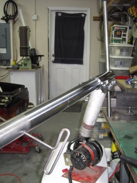

I am supposed to leave on vacation on Friday, and just noticed my right fork seal is leaking... again. I just put these seals in so I don't have any in stock. Now I have to find a set quick. And I have to see if I can find a fork tube to replace the offending one. It has too many nicks to hold a seal I guess. I had them chromed so I am going to have to replace the tube only..

I have several sets of forks, some were damaged, I found one tube that is the correct side. I'll have to chuck it up in the lathe and see how straight it is. My uppers and lowers are chromed so I only want to replace the tube.
I looked for any visible damage to the fork tube on the bike and I do see some pits but they are way down on the bottom of the tube.
But this is probably the 3rd seal on that side. It's getting old.

There is no visual defect on the seal. It looks new. The fork tube has scratches along it's length. Like it was scratching when it moved in and out, like dirt scratches. It has some dings that had corroded, I cleaned them up the last time I worked on them. I thought it would be ok. But it's the only reason I can see.

Left and right are different. The left tube is threaded at the top. The tubes come apart pretty easy. I  just heat the fork lower with a heat gun, or propane torch, and unscrew them. Sometimes they give a bit of resistance, but overall not too bad. I've already replaced the tube. The bad part is you can't just buy a tube. I happened to have one from a wrecked bike I bought years ago.

Just rebuilt my leaking right fork again... Finally (with a magnifying glass) was able to see several vertical scratches on the tube, even thought the seals still looked new and smooth. The scratches were hard to see since all the shine and glare was in the same direction.
So, after getting over the shock of the HDL price for a new tube, I remembered seeing something on the Generic Parts page, and there are links to a source for new tubes at half of HDL's price. Just sent my order in...  cooldude
