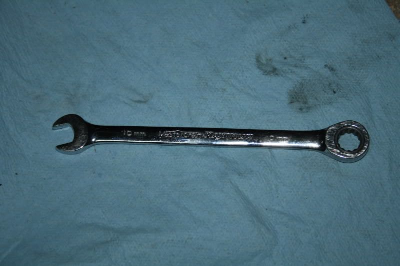

Here is my suggestion for the best tool for the exhaust nuts: the  10mm gearwrench.  Thats the wrench with the ratchet on one end and a open end on the other.  If you get the thin one it fits on every bolt no problem.  The ratchet has a 5 degree swing so there is lots of room to operate.
I just put the exhaust back on tonite and it works great.  It goes onto all the bolts even the hard to get middle rear.
If your really concerned about the torque, just torque one of the easy nuts and find out how much "umph" you need with the wrench.
Hope this helps you.

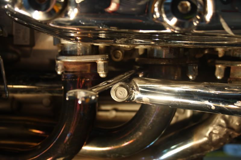

Sometimes getting the correct fit when reinstalling the pipes is a hit and miss, some go back on easy, some not. Here is a step by step from Mark T that has helped alot of us over the years. Take a look and make sure that you torque the header nuts to 7 ft pounds, no more. Mark has a trick for that one. I found a flex driver at the local hardware store bargain box that has a max torque of 7 ft pounds so I use it exclusively for the Valk.
http://www.horseapple.com/Valkyrie/Valk_Products/M2W_Exhaust__System/R_R_Tips/r_r_tips.html
http://www.horseapple.com/Valkyrie/Valk_Products/M2W_Exhaust__System/R_R_Tips/torque.jpg

The ratchet wrench looks like a pretty good solution.  I'll probably get one of them and a 1/4" universal joint for the socket set.
Thanks for the guidance and going through the effort to post pics.  Much appreciated.
