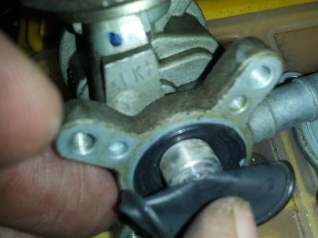

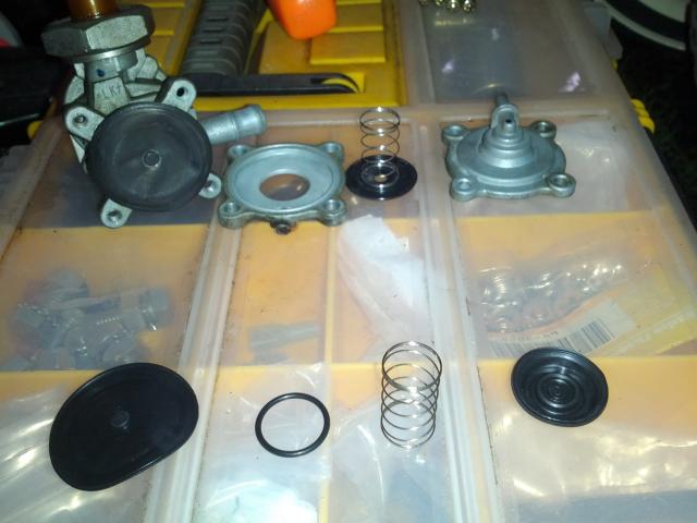

So, I got the petcock kit, but things don't quite look right:
The back is my petcock. The front is from the kit.
Where does the bottom-right piece go?
And then there's this:
EDIT: Not sure why the link broke. Damn you google drive.
Do I just pull the diaphragm out and push the new one in there?
Or is that the wrong kit?
Thanks,
john
And how does one put a picture inline here anyways? Figured it out...
« Last Edit: May 09, 2012, 11:07:40 AM by jabster » Logged

I would buy a cover set and rebuild the petcock. I'd buy the in-tank screen at the same time and replace it when you do the petcock. Ditto what has already been said about the brake and clutch fluids. Drain the "dragon drool" too.
