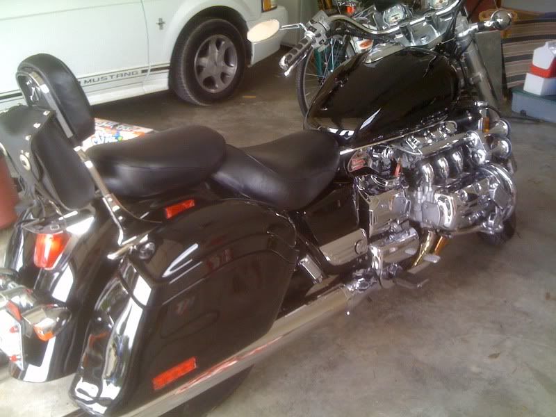

I was in a local bike shop and they said it would definetly take the blue off my pipes. I've tried everything including semi chrome with no luck. It is pricey but does it work? Has anyone tried it?
If you check out the Mt. Mitchell post on this page, you'll see how bad my pipes are. If it really works I'd pay twice as much!
Thanks, Tony
Correction: I posted the name incorrectly and the name is Blue-Job with a 100% money back guarantee. It is a dry powder that you add water to and make a paste. I just find it too good to be true! Undecided

just commenting....yes you have blue pipes.  Im not sure you can cure that situation.  single wall pipes turn blue easily.  also you may be running a bit lean.  new jets maybe are in order?
nice pictures you posted.

I have tried Blue Away, but it was a long time ago, and they may have changed it some. The results were mixed, depending on the degree of bluing. Sad part is that the blue comes back. As others have said, single walled pipes and condition of tune ...  Smiley
I actually had equally good luck with an Amway SS cleaner made for pots and pans. Don't know if they still make it, but the only issue is that is has some abrasive (though very fine) and I would not recommend it in extrememly obvious (flat, lot's of reflection) area.  Cool

Honestly, those are blue enough I believe you'd be down to bare metal before you got all the bluing off.

I used White Diamond Polish to take the blue off my Two Brothers 6x6 pipes.  Did a great job  cooldude  Then within several days of riding, the blue was back.  A whole lot of elbow grease wasted in that effort.  They're still blue and hanging in the Beehive  Roll Eyes

Yes, tried it...no, didn't work. Maybe a little. VERY little, after a LOT of elbow grease. And mine are stock double-walled pipes.

Thanks Greg, the guy I bought it from said he "thought the original owner rejetted" when he put the Cobras on so I really don't know. The plugs look great, real nice tan color and the exhaust looks a tad sutty. BTW, thanks for posting the pic!

The story goes: aftermarket pipes put on, but carbs not jetted, discoloring took place, next owner changed it back to stock exhaust and added long pipes to quiet and move sound back past the wife.
