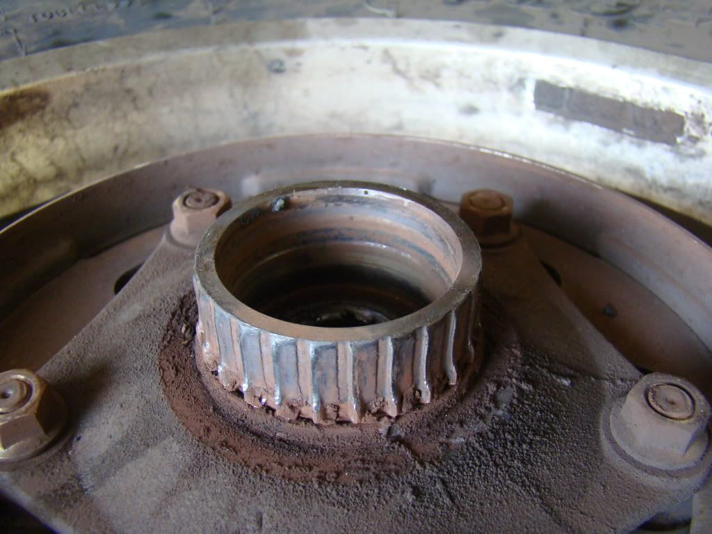

Hummmm... I might have a couple of things I need to do to mine.... like get the whole final drive back together since it couldnt be done while I we were in Cody, Wy.
Think this is possible? I got the "Box o'parts"  to replace the pinion cup flange set and seal to put it back together. Not sure what else I might need.

The bike shop put the rear tire back on it and semi back together(minus the pinion gear that is in the "box o'parts"). Its roll-able so once its latched down on the trailer, it can go anywhere.

I spoke with Larry this evening, and he doesn't have a good setup for a WP, so we can have it at mine.  If its decided its is the official location email me if you need an address at ThagAndy@centurytel.net . I'll be out of town this weekend, so if you send an email then, I'll reply on Sunday evening.  I cant guarantee a hot breakfast like last time yet, but I'm sure we'll at least have coffee.
If there is anyone who is pretty familiar with the innards of the final drive and replacing the pinion cup / splines that would be helpful and much appreciated to get some advice at least.  When the independent cycle shop in Cody WY. tried to put it together, the wheel would not turn when spun and there were pieces left over.

14 and 19 were not put in place.. there is a new gear(#6) that goes on the end of the drive shaft they didnt have the tools to break the shaft to remove/replace the gear. They also thought that there maybe a need for additional spacers (#18) to adjust gap in the pinion gear but that was coming from someone that didnt know where the extra parts went.

I was expecting #13 to be the failed part from the final drive graphic.  Was it?  Were the parts comprising #6 bad, too, or are the new ones "just in case"?
This reassembly is a complicated procedure and spacing and angles are critical.  Shimming may be requried and special "ink" is necessary to make sure mating surfaces on the gears are aligned properly.
I think this is beyond what can be accomplished at a wrench party.  I don't believe any of us has dismantled and re-assembled a rear drive.   Daniel may have, but I certainly haven't. From what I've read on the VRCC tech board, only Ricky-D and a couple of others have attempted it.

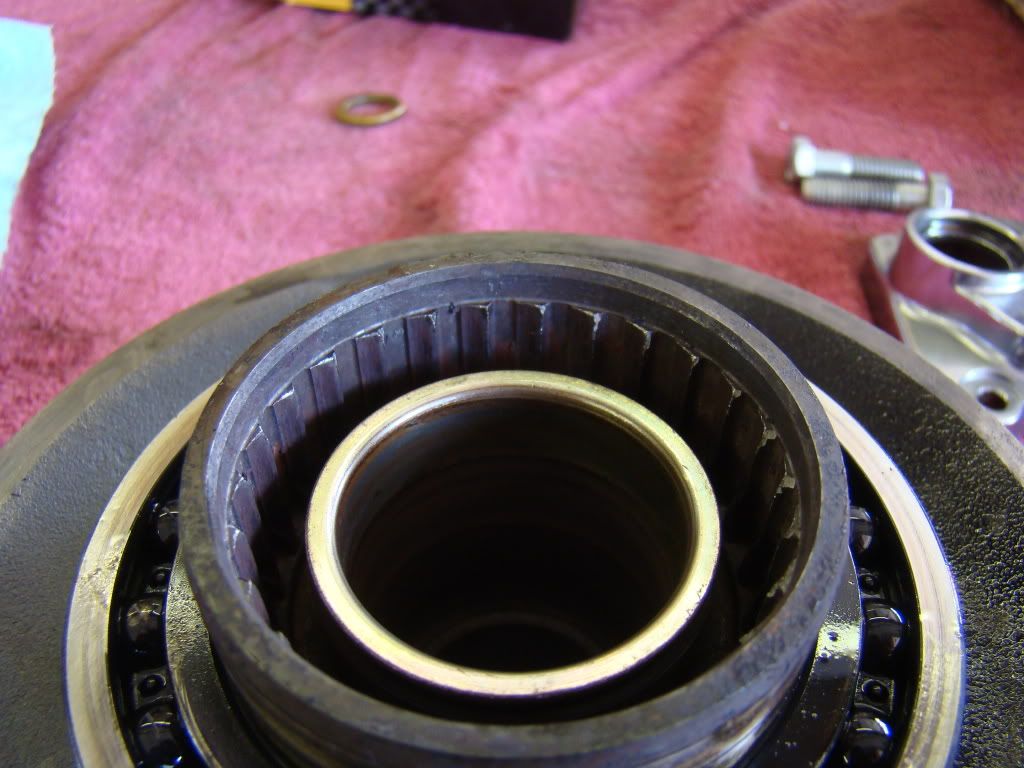

We never saw #13, when they removed the wheel and saw how bad these parts were that what they called as being bad..(See pics below)
It was the inside of cup part of #6 the big pinion gear drive, and all that came as a set. The Pinion gear wasnt bad, so as a last ditch effort they tried to take the cup out and put it in the old pinion ring gear hoping that would match up but after 30Tons on the press, they couldnt get the new cup out.

I'm with Valkpilot on this.  Your final drive should be repaired by someone who's done it before.  Let's get it done right, then put it on a regular maintenance schedule so it will look like these in another 150,000 miles, or so.  http://www.valkyrieforum.com/bbs/index.php/topic,33188.new.html#new

wow.. that does not look good...may want to consider a r & r on that unit with a pinwall or ebay, if available unit , and take your time and overhaul that one..if thats whats showing, there could be other worn parts not showing ?? just an idea..you would have a spare then to.. paul.
