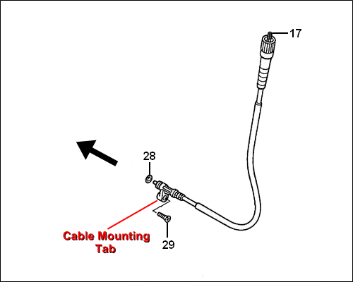

I have a '97 Valkyrie that needs the speedo cable replaced. The plastic piece that the screw goes through on the wheel broke. I have a new cable, but am wondering how hard it is to install. I have not removed the old cable yet, due to work getting in the way. I am hoping to get off work before dark thirty at least once this week, and would like to make the change, if there is not too much involved. Is there anything I should watch out for on the speedometer end of the cable? Thanks in advance for any and all answers.

5 min job. unscrew from the speedo( may need pliers to break it loose) pull lower mounting screw remove cable, reverse for install.
That 'plastic piece' always breaks on many Honda models when you tighten the screw. Unless a fragment broke off, you can just screw it back in place and it won't fall off. Use locktite and inspect periodically.

Sounds like it's not the cable that needs replacing but the outer housing, still an easy job. First, you'll need to remove it from the wheel as stated, then remove it from the back of the speedo. Reverse the process for the new one and you're done. To prevent breaking the plastic part again, always make certain that part is seated before snugging down the screw. I've seen many "mechanics" just stick it in the hole and use the screw to pull it into place. That will break it every time.
