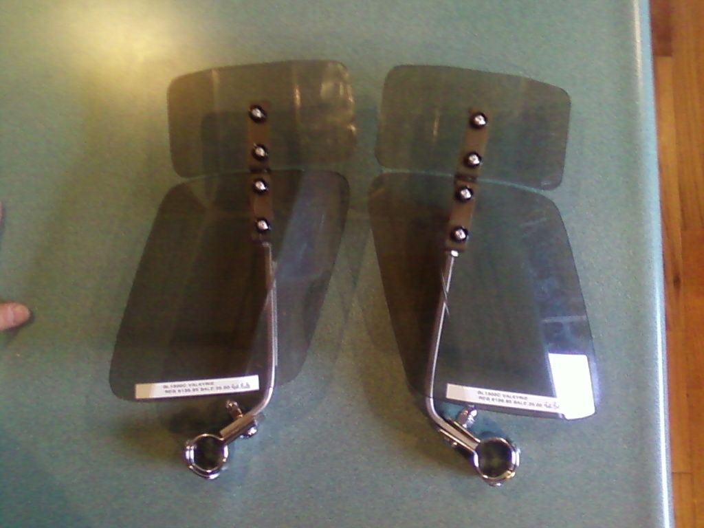

These air deflectors were Marked "GL1500C Valkyrie" on a used and clearance table at the local dealer. They also have a part # on them ,"DS-710373" I was hoping to us them on the IS even though the label indicates they are made for the standard or tourer ;but looks like they mount on the engine/case guard, where the IS radiator pods are located,so they may have to go on the Standard. Can anyone identify the manufacturer or does anyone have a pic of these properly mounted.The dealer will be open tommorrow and somone there may be able to help me, but you guys know better than most how us kids are with the new toys "I want it on and I want it on now!" Thanks for taking a look.

They are the same shape as the Tulsa airwings for Interstates and Goldwings except they have that top piece which makes me think they were for a Standard and are no longer made.

I tried to mount them on the standard, I would have to move the turn signals up in order to turn the forks. I will mess with them somemore. The diameter of the clamp.is the same as the crash bar. And I have not seen mounting hardware on wings like this.

http://www.addonaccessories.net/shop_details.asp?cat=%2E%2EGL1500+Side&prod=WIND+DEFLECTOR+%2D+DUPLEX+%2D+SMOKE
this is the company, i've  owned them before. when you mount them they hook to the bars with the angle to the rear, to clear the turn signals.
