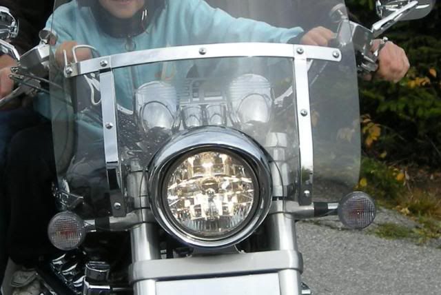

I have this windscreen, wonder if it will work?
The bike is a Standard, 2001
