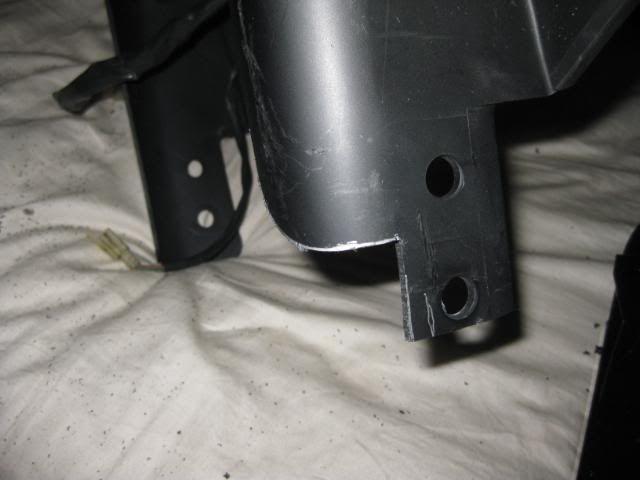

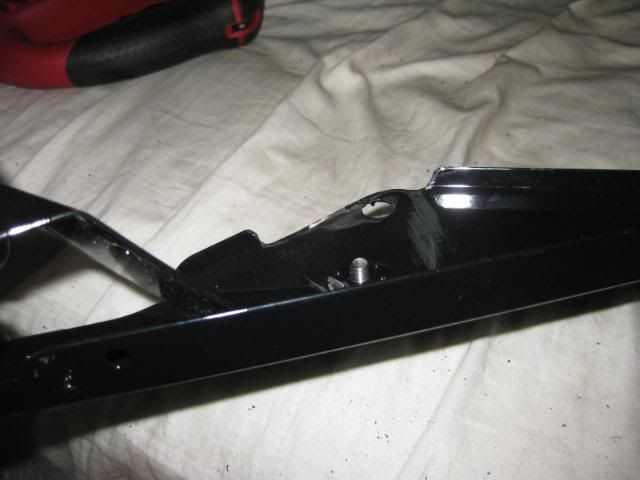

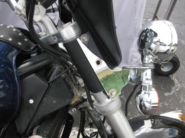

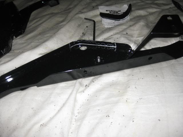

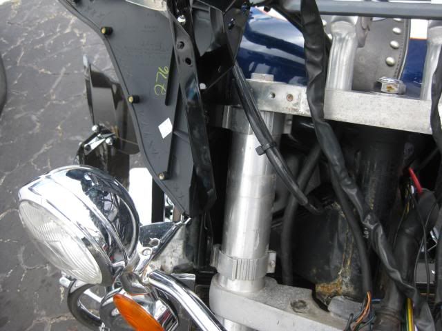

well time to upgrade the fairing as i managed to dump the bike and break up the Memphis shades fairing.
It took a week or so to gather the parts from Ebay.

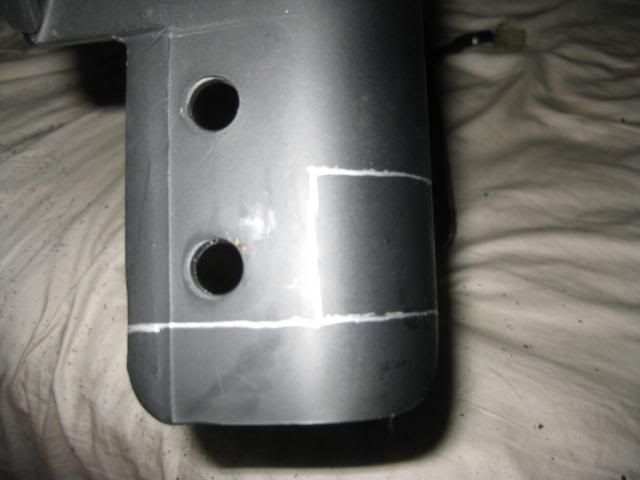

 First thing i did was mount the upper faring mounts to the inner fairing. then slid my upper Memphis shades clamp to the very top of the fork tube. sliding the inner into place i marked where i would need to cut to clear the upper trippletree. a quick 5 mins with a grinder and they were done.
next i adjusted the lower clamps to line up.<< NOTE: the outside face to face of the clamps is the correct width for the Harley mounts.>> after paint and remounting them to the inner,i bolted the inner in place. swinging the bars from stop to stop i found that the lower leg covers contacted the radiator. a couple of quick marks and some jigsaw work and the problem was fixed.
next i attempted to install the outer fairing , but , found a clearance problem with the gauges contacting the outer shell. once again to the grinder. (the gauges are inside the fairing so weather is not an issue)
a couple of other clearance issues related to the older Shovelhead light bar i had previously installed and the install was complete. total time 2hs 50mins.

« Reply #7 on: November 09, 2011, 07:37:17 PM »
i used the memphis shades fork rings only. as you can see in the pics, i modified the original harley upper mounts to bolt to these clamps. all parts were purchased off ebay.
