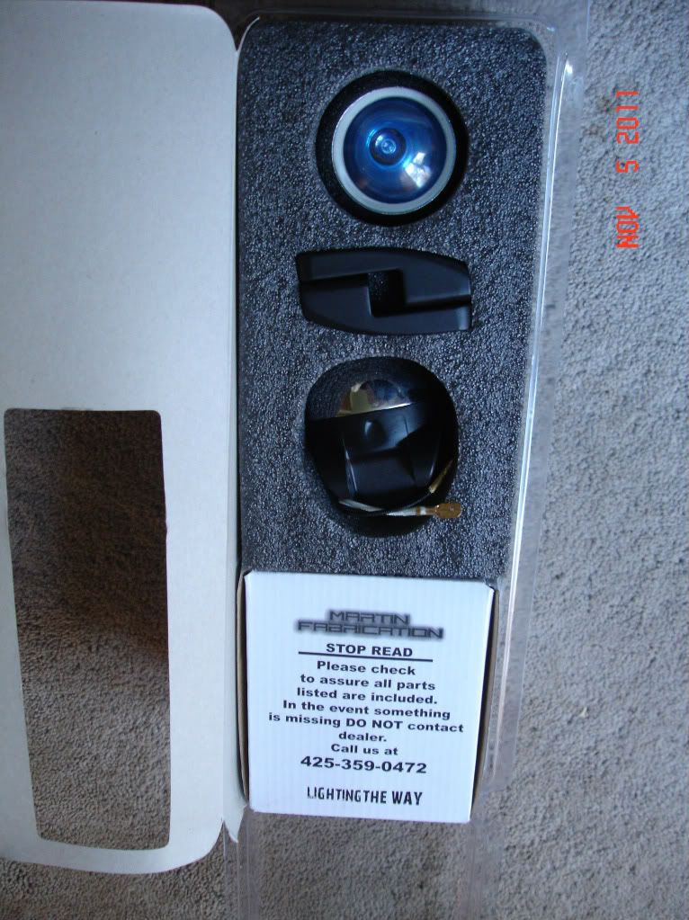

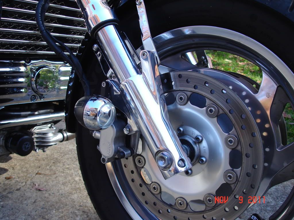

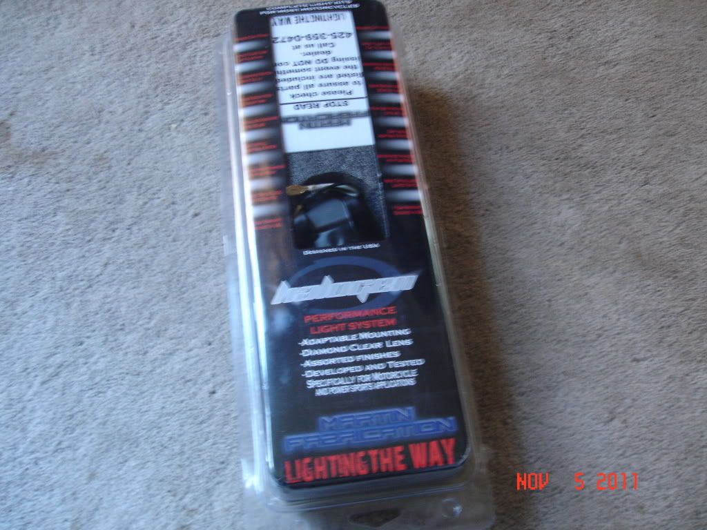

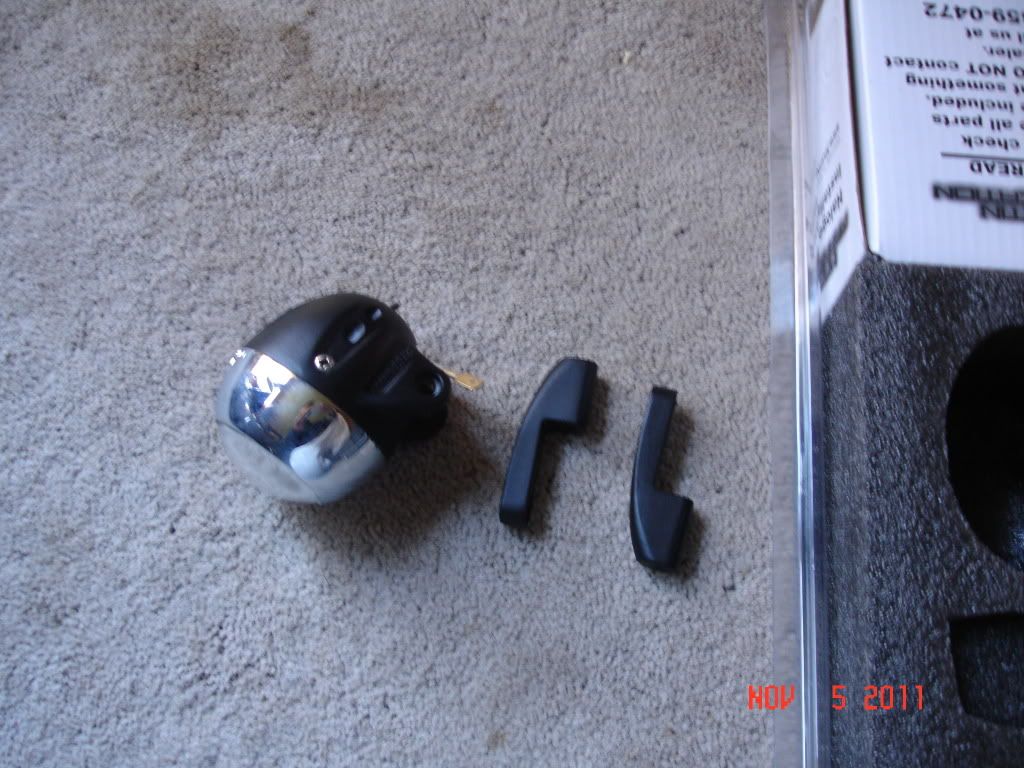

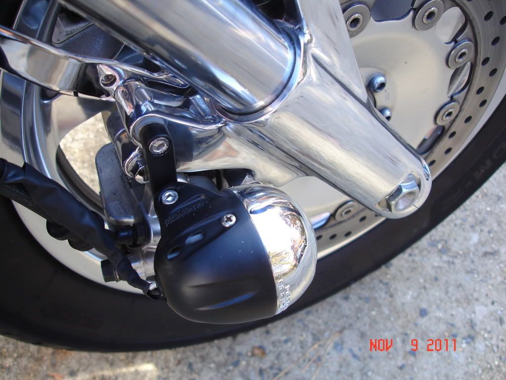

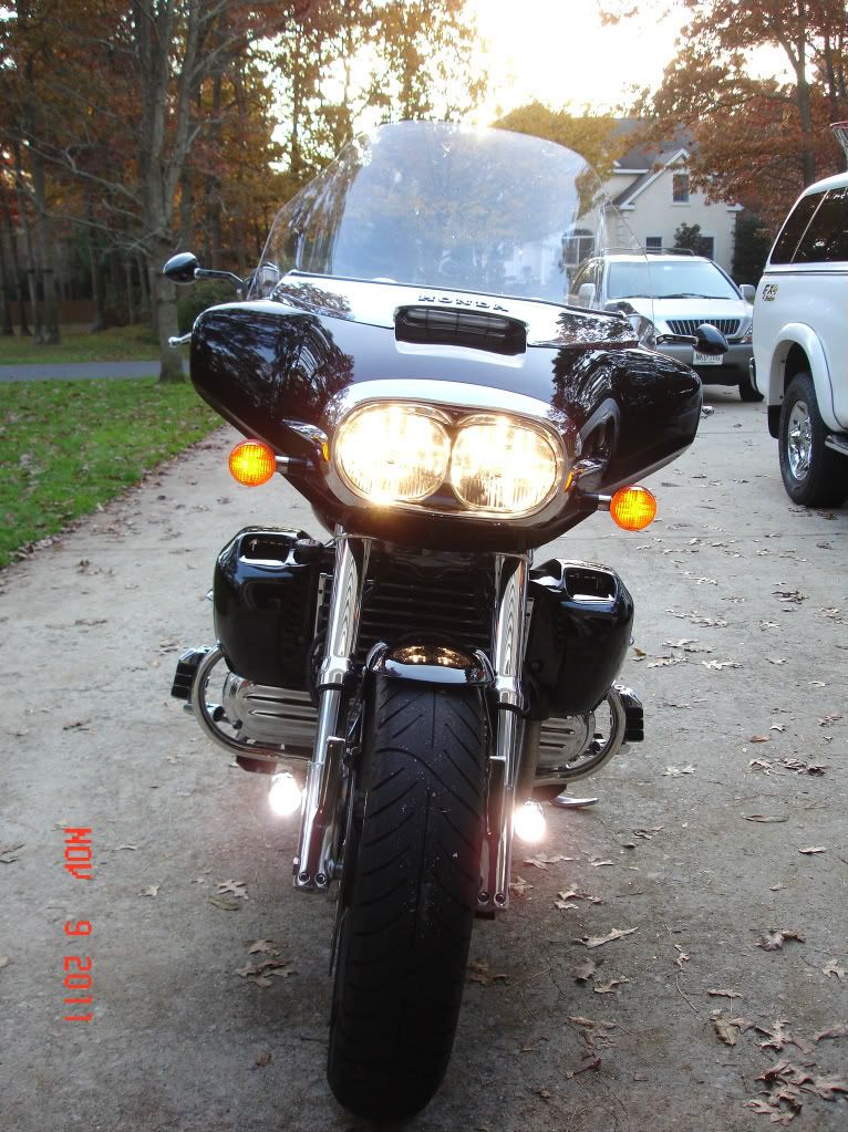

I have always liked the Motolights for the Valk but couldnt justify spending that much on lights even though they are made well.  I found these driving lights on the internet and dont recall seeing anyone post them before so I figured I would let others know about them.  They are made by Martin Fabrication.
http://www.martinfabrication.com/Martin_Fabrication/Motorcycle_Lighting_Home.html
They were listed as a fit for the Valk.  I called the company and talked to them first.  Got the lights and they are very well made.  They come in black, chrome or black and chrome.  They include all the wires, bolts, nuts, mounts, waterproof lighted switch as well as multiple extra bolts, spacers, washers and two extra bulbs on top of that.  I was impressed with the packaging when I got them and couldnt wait to see them installed.  The site has listed them as 35 watts but now they come with 45 watt lights.  I got the standard lights, not the HID's.  See for yourself in the pics I posted.  They mount by replacing the fender bolt with one of theirs and the light mount.  No affiliation at all, but for the price I think they are a great buy.  Oh yea, Made in the USA!

Steelers, that is a nice write-up, thanks.
My supervalk came with the Motolights and I love them, but cannot afford to add them to my other IS.
Are the mount arms metal or plastic/polymer?
Do they appear to be completely waterproof?
You refer to a fender bolt, but they look like a caliper bolt mount.
Is there a factory warranty?
Please keep us posted on how they work.

Arms seem to be some type of metal, very light, maybe aluminum.
Mounting is done by replacing one of the fork lower bolts.  I have a VTX fender on my bike.  The bolt goes through bracket, through the fork lower and into the VTX fender bracket.  On stock front fenders, the bolt goes through the fork lower and then straight into the fender.  It does not use the caliper bolt, that is way too big.  I asked him about that when ordering and he said that isnt a good idea because of the movement the caliper has.
The lights are made specifically for bikes so I would hope they are mostly waterproof.  I did ask him about a warranty and he said he stands behind his products if there is a problem.   Im not really sure on that I guess.

When you swapped out the triple tree did you swap out the fork tubes as well?  Those polished forks look super nice..I like those small lights as well..

Yes I did.  I had too much time with polishing them and money with the Progressive springs to leave them.

Did you cut down your fenders or did you buy them like that?

The front fender is from a VTX and the back fender is a stock fender that is cut down and filled.

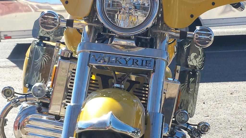

just so u know those lights are a generic made light. PIAA has same ones of course with their name stamped on them for $300. I bought same lights from pepboys for $52 in '00. They finally were put to sleep last yr., reflective material was peeling and one lens cracked. not bad for the money.
now use $20 all chrome lights from walmart that use the MR-16 bulb. This style bulb was top rated by motorcycle consumer news a few yrs back. many types of MR-16 bulbs can be bought, such as the degree angle of the spot or flood.
I have the lights mounted on the radiator sides.
