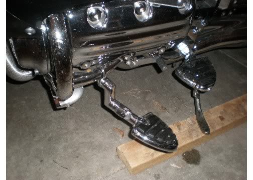

I'm the same as you.  5' 11" with 30-31 inseam.  It is a Kury Magnum clamp with about a 2" offset and a 1 1/2 extension in the end of the peg.  I had the Mick-O-Pegs but didn't think I gained much especially with my shorter legs and the fact that my driver pegs have been lowered.  The Mick-O's didn't offer enough difference.
Please excuse the water spots.  Haven't gotten her cleaned up since a ride in the rain. Smiley

They (Kuryakyn 4050s with 1 1/8" clamps)will fit an interstate, but only clamped down behind the IS scoops welded on the guards (so a lower mount than optimal, thus not recommended for IS).
I have them on my IS and my scoops were cut off so they mount right up at the guard intersection (guard upright to outside curved guard bars) where they belong.  The scoops are meaningless and if cut off only show if you lay under them and look up (coat the cuts with clear stuff/nail polish to stop corrosion).
The best feature of these pegs is the bulletproof clamp, whihc you can stand on, unlike Kury Quick (or other ordinary) clamps.  And the offset and dully pegs can be rotated for personal fit to your legs/boots.  And when folded up they will not hit in a tip-over (unlike the ones I have mounted directly to the outer sweep of the engine guard on my other bike; with quick clamps to clevis to duallys).  FWIW, where I have the pegs set for my boots is very close to the same position on both bikes (as you would expect). The pegs on the guards are a bit higher and wider, and are the widest part of the bike when folded out, so doorways can whack them and they will move in a tipover.
Some have mounted the 4050s below the scoops (without cutting them off).  It works, but with a lower mount: but if you set your pegs low on the offsets (like Mickopegs), they will easily drag in a lean (if you ride your hwy pegs in leans).  This is why Mickopegs are spring loaded and can bounce up (and why I don't like them).  But I have short legs, and I think longer legged guys like them.
Mine pegs are up near the curved guards, and I set them so I can put my boots on them with bent knees, or slide my heels over them and sit straight legged (here I must watch burning my calves on the rear valve cover corners).
