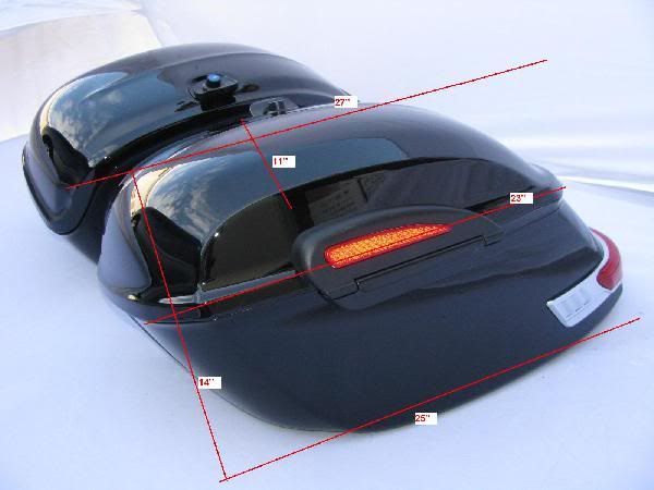

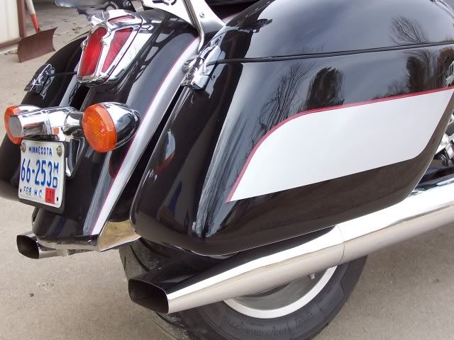

Here's a few pics of the Tsukayu "Strong" bags on my '99 Std.

They look really nice! No problems getting them on?  They look great!!

Thanks !!  As was mentioned earlier, you'll need to take careful measurements as the Tsukayu bags have NO mounting holes .... you must make your own !! When I mounted mine, I sat the bags up on some car ramps and used pieces of wood to get them at the height I wanted and took LOTS and LOTS of measurements.
Tsukayu recommends 1" of clearance between the bags and the exhaust. I have a Hitch Doc hitch mounted on my bike and found that in order to open the bags, and clear the riders seat (Mustang), and have good leaning clearance (foot pegs hit first) I had to have 1 1/4" between the bags and the exhaust.
And because I'm kinda anal on making things look right I made a virtual box out of some scrap plywood to make my measurements on the bags so they end up the same for both sides.
The other thing I did was have a machinist make some 1/4" aluminum plates for better support behind the bags and used big fender washers on the inside. Also put a piece of 1/16" neoprene rubber between aluminum support and the bags.
The tops of the bags are lower than the top of the fender by over an inch.

Thanks for the compliment but really, I've already done all the grunt work. If you like those bags and wanted to position them the same as I did I could easily give you the dimensions on where to drill the holes in the bags and you're good to go. You would have to drill four holes in each bag and then bolt it up .... pretty simple !!
The hardest part for you would be dealing with the fender strut bolts and that would be the case for what ever what kind of bags you bought. As long as you do one bolt at a time, you'll be OK.
Also, if you don't have access to a machinist for the aluminum backup plate (which I also have dimensions) you could substitute some fender washers instead or just use the mounting brackets as is. The bags come with all the necessary hardware.

Hey Sodbuster, How about some more pics of that sneaky Hitch Doc Mod. What type of receiver do you have? Thanks

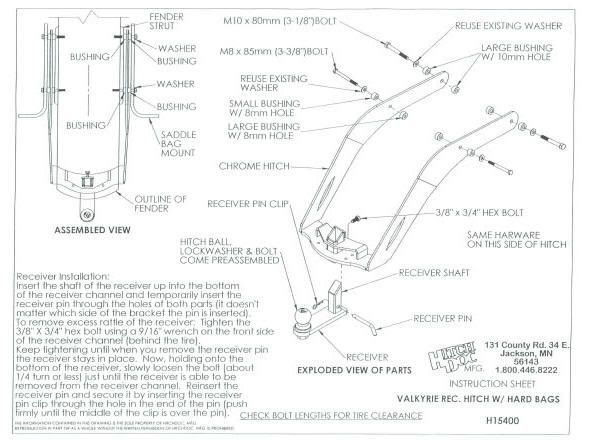

Actually .... it came that way  Wink
I don't have a pic but here's the instructions from Hitch Doc

I love the look of those bags and the large size..looks like they were made just for a Valk..I see them for a buy it now on ebay for 305 bucks.  WAY, WAY cheaper than OEM bags.
Yeah that's what my Dad (RTaz) and I thought too.  They were economical and look like they should be on the bike to begin with.  They are a little wide (11 inches) but for the fat girl they are just right, I would not put these bags on  v-twin though in my opinion they would be too wide.
