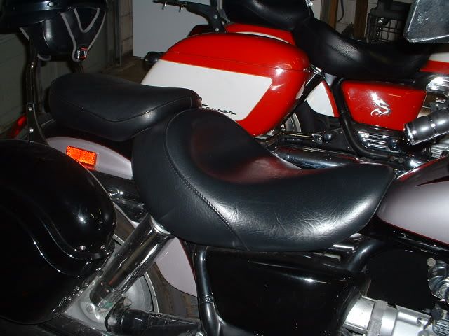

Is the new passenger seat better also? If you buy one and not the other does it look bad?
If you look closely at the pic I posted you can see the difference in the "grain". The fact that you have to look closely to see the difference kinda sums it up.  cooldude
