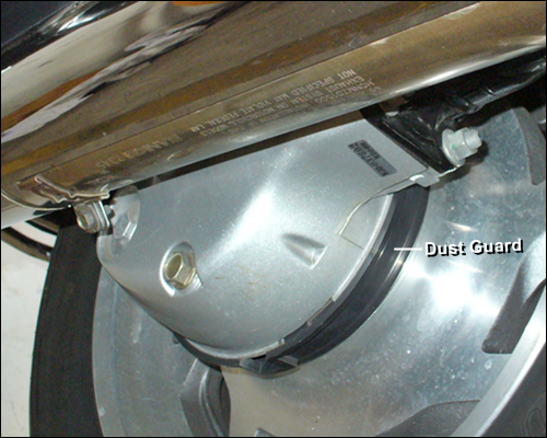

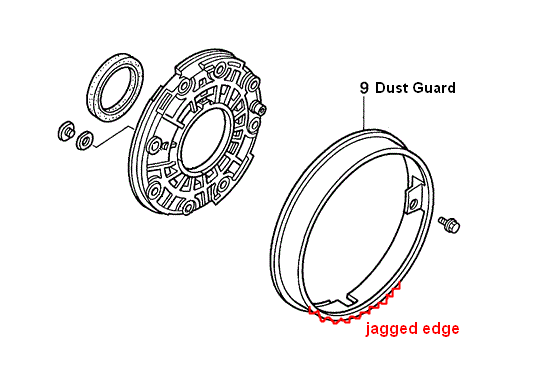

I took off my rear wheel and the Dust Guard (below) was frayed on the bottom section of the circumference, approximately from the 4 o'clock-to-7 o'clock sector. Is this an indication of something that I should be concerned about, a little, a lot, or not at all? The circumference of the dust guard contacts the right side of the spinning rear wheel. The edge isn't torn, just jagged. The rest of the same circumference is just fine.

The wheel should not contact the guard (when the axle is in).
Is the guard warped, or perhaps not all the way attached to the pumpkin? (it sort of locks in with a twist after the single bolt that holds it is removed)

I'd guess it wasn't installed properly the last time it was removed. Carefully reinstall it and recheck for rubbing. It's not an issue to have it frayed a bit. Just keep using it.

If the splines are good, that means the final drive was installed properly.  If the guard is touching the wheel, I would bet as has been mentioned it was NOT installed properly.  There is a screw on the inside face of the final drive that has to be removed, then twist the guard until it can be removed.  Install in revers order.  It doesnt snap on or off and dont pry on it.  If its still drags, its probably been warped....just trim away what rubs and dont worry about the guard......worry about getting the final drive on right

I actually never had the plastic dust guard removed from the pumpkin, but by the same token, I may have bumped the dust guard crooked whilst finagling the wheel onto the pumpkin or knocked it ajar while scrubbing the wheel with a cleaning brush. If the dust guard is excessively deformed than it's a $19.00 replacement or use a scalpel for less. A month ago when I had the rear wheel off, I noticed the circumference of the 'aluminum caldera' for lack of a better term of the hub had developed a roughened surface. Specifically where the dust guard overlaps the wheel. Just sumpthing that you take note wasn't there previously. Moreso with the fraying on the dust guard's edge becuz it wasn't there just last month. Been wondering if I should pay more attention to the memo. Anyways, I rubbed some Belray grease around the wheel's mating lip (a month ago) to no avail if the two problems are related at all. Perhaps the fraying on the dust guard is an indication that the pumpkin's collar isn't in straight as it should be and the off kilter causes the dust guard to rub against the spinning wheel where it shouldn't. Pic below for newer forum members who may be following the discussion.
