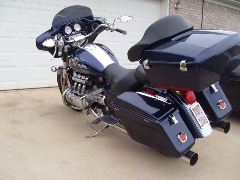

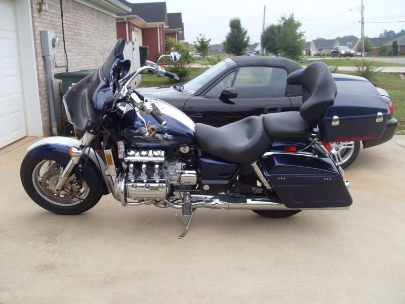

The first part of my conversion to a full touring bike has been completed. I went with a harley fairing build, and added 4 extra gauges. The light bar came from a harley as well. I made brackets based off a harley, and attached them to memphis shades fork clamps. This mounting made mounting the hd light bar just like a harley.
Next is to get some good hard bags, and I'm thinking of going with the Tuskayu Jumbo Strongs. The only reason I haven't already ordered them is that I want to us a harley tour pack or one of that same style. I'm just not sure how they would look together. Everything I've read about the Tsuakyu products has been posative. Does anyone have a good size comparision to the Tourer's OE bags, I've been looking for deacent set and always fall short with my wallet.
Also if anyone is interested on possibly knows anyone, when I do make the final decision I'll have a set of k-drive bags available.

Dave, what model of HD fairing is that from? I have one mounted without the inner part, from an FLHT as I recall. I'd like to add the inner fairing but not sure what would fit.

Nice job on the fairing.  I likey.   cooldude
Don't know how to compare the Jumbo Strongs to the OEM's.....but the Jumbos are veeeery wide.  They WILL make your butt look big.   Grin  I've seen pics of a few bikes with them mounted.  If you want, I can post a few here later.  The Strong bags (the Strong bags....not the Jumbo's) are veeeery close to the OEM, but have more of a slant at the front.  Here's a link to a guy that mounted the Strongs....and also mounted the Tsukayu trunk on his Valk also.  He has lots of pics and installation tips....
http://www.valkyrieguy.com/
I'm working on mounting a Harley leather tour pak mated with a set of Mustang bags on mine.  They are the exact same bag as the Tsukayu "quick release strong" bags.....just with Mustang's covering.  I'm mounting them with OEM leather bag mounts that I'm welding some plate too.  One side is done and I'm waiting on the other side to get welded (it's been a long wait...but that's another story.....I really need to learn how to weld....especially TIG).
As for a Valk with hardly bags.....there's a pic or two on this board of someone with a red Valk that has Harley bags and a Harley tour pak mounted.  I thought I had that pic, but haven't been able to find it to post it.  Maybe someone else that has it will.
However....here's a bike that has a Harely tour pak mounted that has some Harley looking bags mounted.  I don't think that they are Harley bags, but they're close.  They look very much like the Tsukayu Patrol bags.
The outer is supposed to fit the 96 and up FLHT line (got it from Calvary fiberglass on ebay but haven't seen any from them since), inner is from the newer 07 up I believe since it doesn't have the hole for the throttle cables.

« Reply #29 on: February 01, 2012, 11:32:25 PM »
Heres my 97 Valk with the jumbo strongs, and yes they were a pain to install uglystupid2
« Last Edit: February 01, 2012, 11:35:28 PM by Garfield » Logged

Garfield.....
How much room did you leave between the bottom of the jumbos and your exhaust?  It doesn't look like much....1/2 to 3/4 inch maybe.  Any heating issues on the bags?
Hey BF there about 3/4 of an inch from the exhaust, and I haven't had any issues with the heat from the exhaust.

« Reply #37 on: February 03, 2012, 12:48:47 AM »
They look great, what kind of exhaust is that?
How wide is your valk overall with them installed?
The exhaust is OEM with the baffles drilled out with 4" truck stacks and Grumpies tips on them. I have never messured it, but I know she sure is a wide fat bottem girl, and the hitch I put on her just made her a lot wider 2funny
« Last Edit: February 03, 2012, 12:50:54 AM by Garfield » Logged
Thanks Garfield.   cooldude
