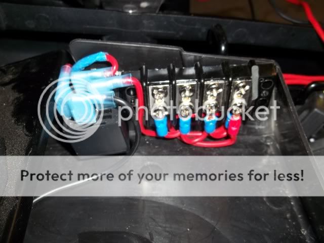

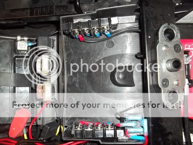

Would work on a Valk as well.  Killed my battery the other day leaving the GPS on, so wired up a "keyed" distribution block (only on when the key is on).  Went to an autoparts store and picked everything up yesterday.  Works like a charm so far.  Hardest thing is finding which keyed wire you want to tie into to energize the relay.
Hot on one side and ground on the other (you can't ground to the frame on a Wee because of different metals, etc).  Mounted inside the "glove box" under the seat.
Still have to tidy up the wires and make a permanent mount (just temp right now until I get the fit and finish right).  Anyway, going to do my Valkyrie next.  Whoooo-Hooooo.
Sure hope I spelled everything correctly.  2funny  I sure would hate for the spelling/grammar police to write me a ticket or anything.
For folks that may want to make one.......
http://www.canyonchasers.net/shop/generic/relay.php

You know the Stroms, Strider.  Yeah, the frame is not a good ground, can cause all kinds of problems.

I installed a Centech fuse block/relay on my Valk.  Works great and is easy to install.  I have the model that has both switched and unswitched connections.
