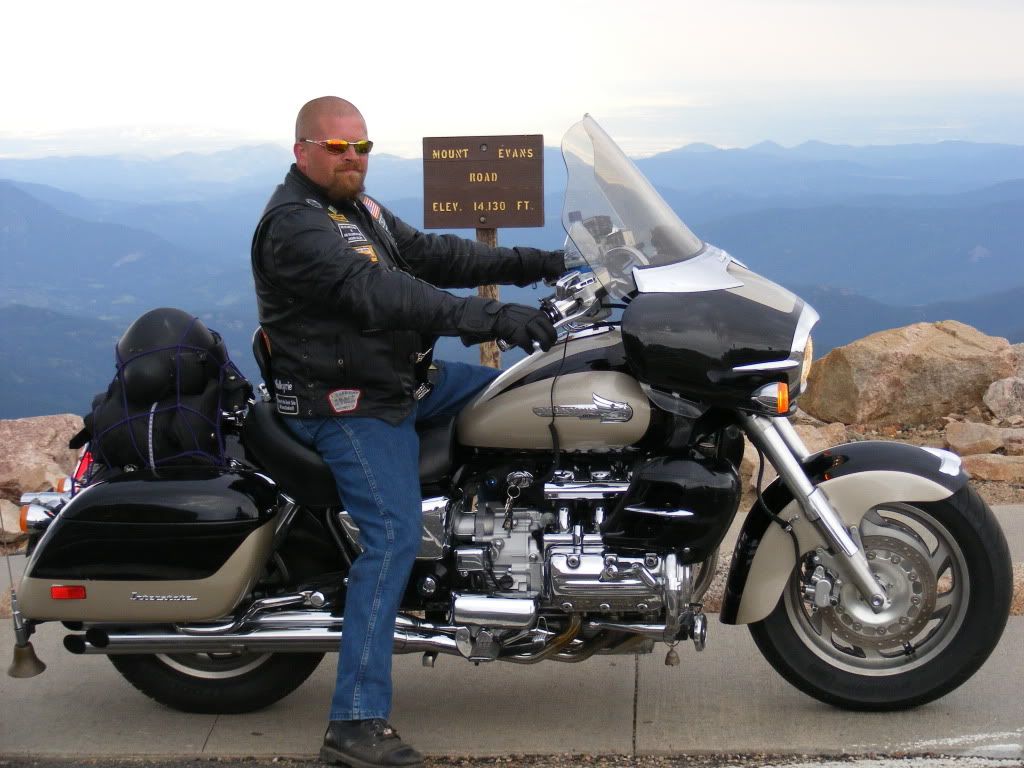

« Reply #9 on: January 15, 2012, 09:32:38 AM »
Yeah, what the others said - no need to rejet anything for cross country touring.  Been up to Mount Evans and even chased Misfit down off of it - no problems.  Check the air pressure in your tires every morning before taking off.  I found that more affected than anything at altitude.  Been running through the Rockies many times and I live in Louisiana - you don't get any closer to sea level than where I live.
You may notice (or may not) a slight loss of power at altitude, but the Valkyrie has plenty in reserve anyway.  Plus, if you are at high enough altitude to notice loss of power, you are probably more busy checking out the sights anyway!  cooldude
Just give the bike a good "once over" and ride er baby ride er - she won't complain.
I found I had more problems with my OWN carburation at altitude than the Valk did.
I think my brother noticed more of an issue on a V-Twin than the Valk did.  He said you could definitely tell the difference between his carbureted Harley and his wife's fuel injected one.  Don't worry about the Valk - she won't give you any problems.
