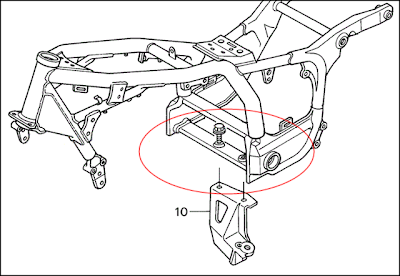

« Reply #17 on: January 17, 2012, 06:38:32 PM »
I believe the OP already owns a jack adapter. Jackstands would be set up 'under' the jackadapter within the circled area (below).
2000 Valkyrie Tourer

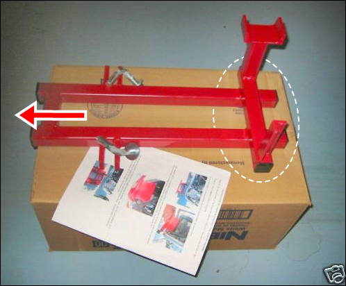

dr.danh
Posts: 139
« Reply #21 on: January 19, 2012, 04:54:48 PM »
That looks to be the one purchased off E-bay.

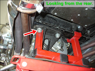

Ricky-D
Posts: 5031
South Carolina midlands
« Reply #22 on: January 20, 2012, 08:10:53 AM »
Mine is a metal one also. However on mine, the single vertical leg is a square tube rather than the angle iron.
I like this small feature (square tube) because the tube pilots on the bolt and nut protruding down from the frame. The one that holds the side stand on! Makes for a good positive placement.
Much more positive in my estimation, less chance for slipping which is great because of the metal to metal contact.
2000_Valkyrie_Interstate
frosty
Posts: 152
« Reply #23 on: January 22, 2012, 09:53:14 AM »
The tube were the first to come out. (Old style) But wouldn't work with all exhausts. The inside of tube would hit some exhausts as Cobras. The angle now works better. Positive placement , Easier to install and will work with ALL  exhausts.
