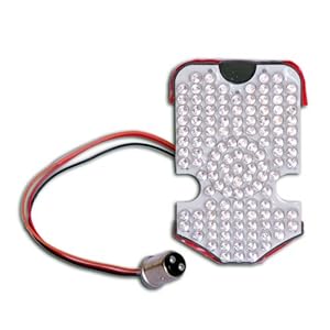

Is this the one you're talking about?
Damn....100.00 is a lot to pay for a light bulb.
http://www.radiantz.com/index1.html?c5.html&1
Posts: 31195
« Reply #6 on: January 23, 2012, 05:46:31 PM »
Actually, it is 128 red LEDs.

« Reply #7 on: January 23, 2012, 05:57:19 PM »
A lot to pay? Perhaps, but in my opinion, just the possibility that having a ridiculously bright tail light might save me from being run over by some half blind, blue haired little old lady down here in Florida, makes the LED unit worth every penny.
Plus you have to see it to understand exactly how much brighter than just a regular 1157 bulb it is.

« Reply #10 on: January 23, 2012, 06:05:37 PM »
I agree.....People actually think your brake light is on untill you actually apply the brakes.....Then it's holy crap that thing is bright!!! Love mine. Don't remeber exactly where I got mine but it was around 80 bucks wth free shipping.....Shop the world wide interweb thingy and you'll save some dollars.  cooldude

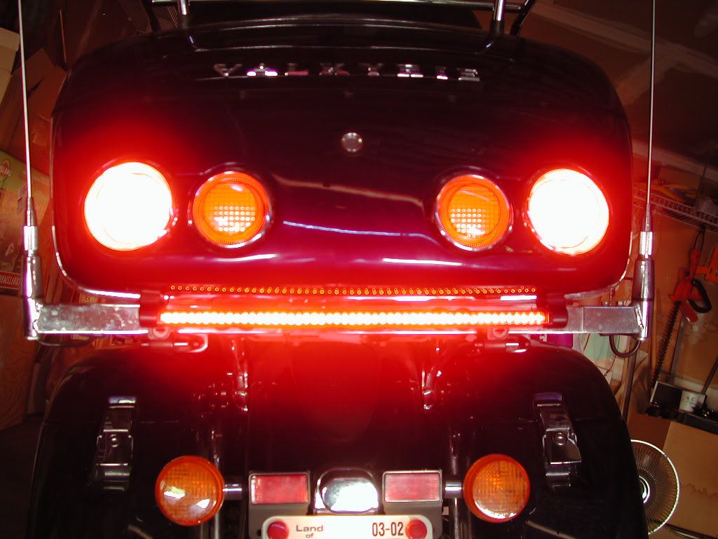

« Reply #11 on: January 23, 2012, 06:11:13 PM »
That 128 LED bulb up a couple of posts, here it is in normal running.
Here is is with the brake light on.
Both of these pictures were taken in a well lite service area.
I don't remember where I got my bulb, but it came from one of those light stores, and it has been in there close to 13 years and all 128 LED's still light.
Notice the reflection in the brake light picture off of the tractor seat.
Money wise, ya get what ya pay for,  I don't care what ya do, I'm just showing you what is out there.

Could you be a little more specific on what needs cutting out?
At the top of the reflector there is a tab that prevents the LED unit from fitting far enough back at the top for the lens to fit back on. You either have to cut or bend the tab back. (I just bent it)
Also LED's are pretty directional and I found that due to the angle of the installation in the housing, the LED's were aimed up and so vehicles behind you don't get the full effect of the light unless they are REALLY close with a line of sight several feet above the light. To improve this, I used my handy dandy Dremel tool and ground out a groove in the plastic at the bottom of the reflector/housing. This allowed the LED unit to sit in about half an inch further at the bottom and shine more straight back instead of upwards.

« Reply #15 on: January 23, 2012, 07:11:16 PM »
Here's what one looks like lit up.....

« Reply #22 on: January 25, 2012, 03:26:03 AM »
Made my own.
It was a lot of drilling and checking and ended up a little bit out of straight line.
Seemed like a good place to mount my shrader valve for filling my 416's also.
