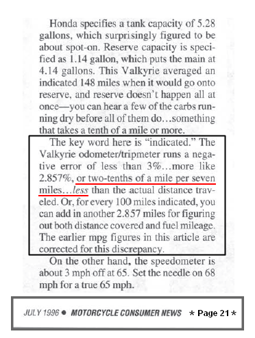

Yes it is strange, I am actually going 5 MPH faster than the reading on the speedometer.
Does this affect recorded mileage? I fueled up 5.98 gallons, and had 181 miles on the tripometer.
Could it have been closer to 200 miles, since the speedo is 5MPH slow? Or does one have nothing to do with the other?

.... I am actually going 5 MPH faster than the reading on the speedometer.
'Faster' on the speedometer probably equates to 'less' on the tripometer with different aftermarket tires affecting the reading more up or down. However, if you factor in the inherent inaccuracy of the factory calibration, the proper size aftermarket tire might even adjust the mph and mileage back to a zero error. Anyways, try read the article below about the accuracy of the odometer/tripometer.
