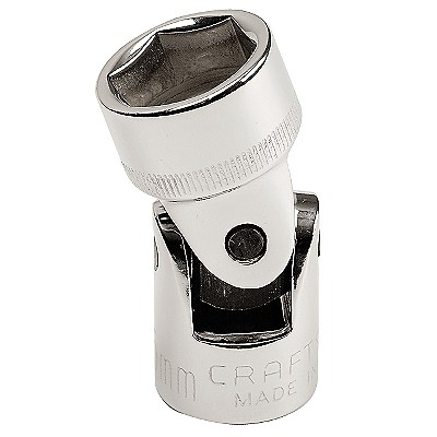

I use a 1/4 universal joint that has 10mm socket mounted on one end and a variety of different extensions. I also don't use a torque wrench (spec is 7 ft/lbs). I use a 5 inch breaker bar which I push with a thumb calibrated with 50 years experience. I've been using that particular wrench for 50 years, BTW. It belonged to my Dad when Craftsman wrenches were made in America with American steel.   Wink
At Sears
Mase, have you used this socket and is it deep enough for the acorn nut that it doesn't start to round over the corners? Might have to add this to the tool box. Thanks.
