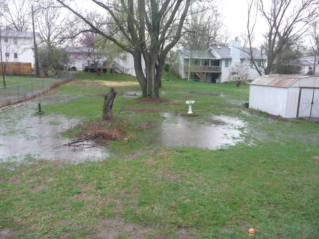

need advice on how to drain my back yard. no access to put a drain to the storm drain.
yard is lower than surrounding yards. would a "dry well" work? think that's what it's called.
drill a 12in hole bout 4 ft deep in the low spot and fill with gravel.
ANY help appreciated.  thanks in advance. Undecided Undecided

If your on sand the dry drain would work great. Line the hole with filter fabric and fill with pea gravel. If your on clay your best bet would be to bring in some dirt and raise the low spots and put the water back on your neighbors  Grin.

not on sand or clay, just good dirt. would plugging help?

It'd take a LOT of soil to build that back yard up to get it to drain to another yard.....I have used "dry wells/pits" in the past....I would use more than one.....find the center of each low spot and sink a hole at least 12" wide by 4' deep.....you can use the cardboard cement tube forms to wrap a landscape fabric around.........put it down in the hole, fill with a 57 stone and then pull the form out a little at a time as you fill the hole up.....or.....I have used a small back-hoe to dig a 4'x6' pit, lined it with a landscape fabric using sod staples to pin it to the sides and bottom, and fill it back in leaving the top few inches covered with soil.....
of course, if you have a very wet or heavy rain where the water table rises in the ground, the success would be limited.... Sad

« Reply #5 on: April 08, 2012, 08:28:51 PM »
bf,  not likely. we've been here 34 years. not moving any time soon. (when i die) LOL
stanley, thanks, that is what i had in mind, exactly. glad to know i'm in the right track.
would hate to do all that and it not work.

pull that stump ...       cooldude
the water will settle into the hole           Smiley
Also, since you're already taking these steps, consider installing a pit with a sump or septic pump and pump excess water to where you want it.  Yes you'll need to run electricity (underground) and then install an underground pipe to where ever you want the water to go but, that beats the heck out of wading through ankle deep water when it rains.
