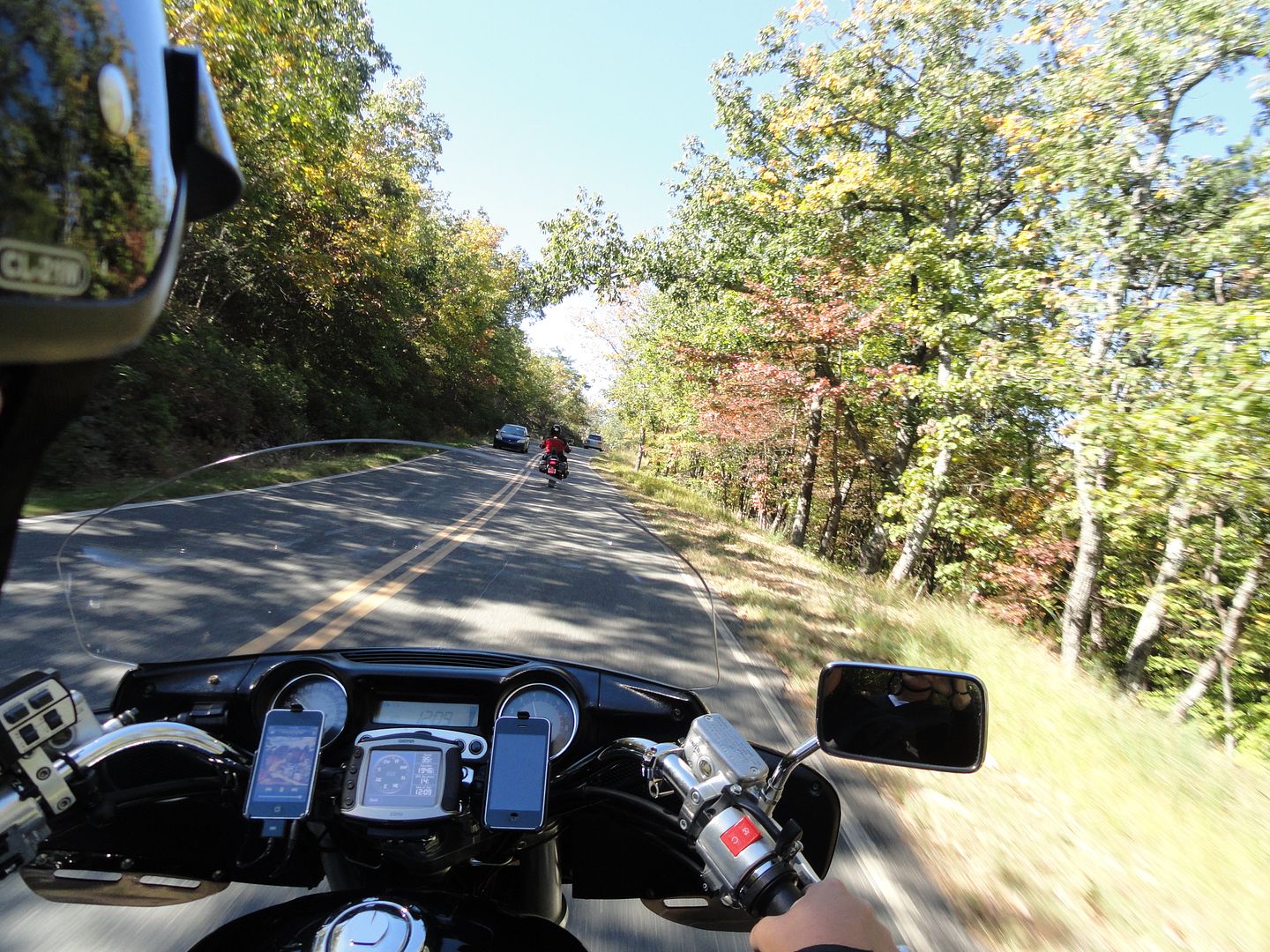

I have been using RAM mounts for IPhone and IPod touch for years. Don't find them "clunky" at all. I think they are minimal and they really hold the I-whatever really secure, never a problem in tens of thousands of miles.
http://www.gpscity.com/ram-mount-apple-ipod-touch-g2-cradle-ram-hol-ap7u.html
I have a RAM ball on each side of the handlebar clamp and use the 1.75" arm to attach the RAM mount to the RAM ball.  IPod for music, IPhone to see when I get calls (I am on call for work 24/7, so I need to know when the phone rings).

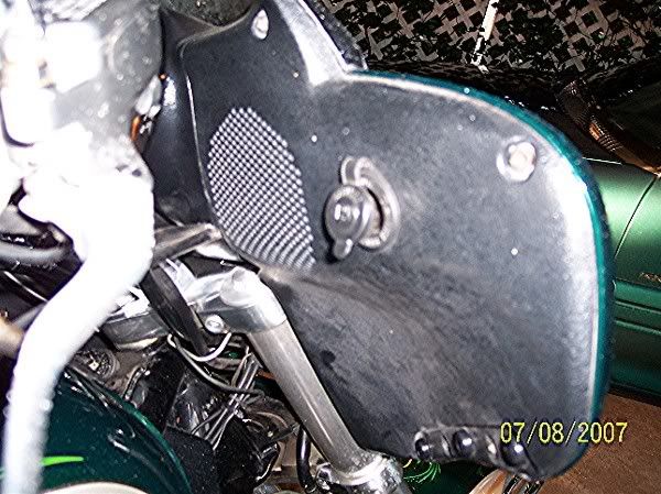

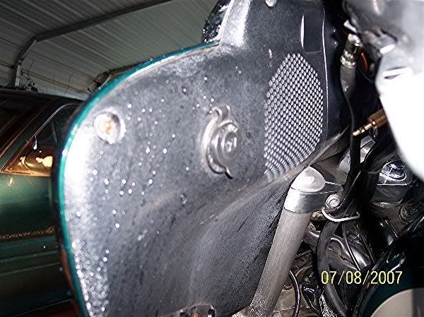

As far as power, have cigar lighter plug under the fairing and just use power plug that plugs in the cigar lighter with a USB port. Just run the USB power to the Ipod and also plug in to the AUX on the I/S.

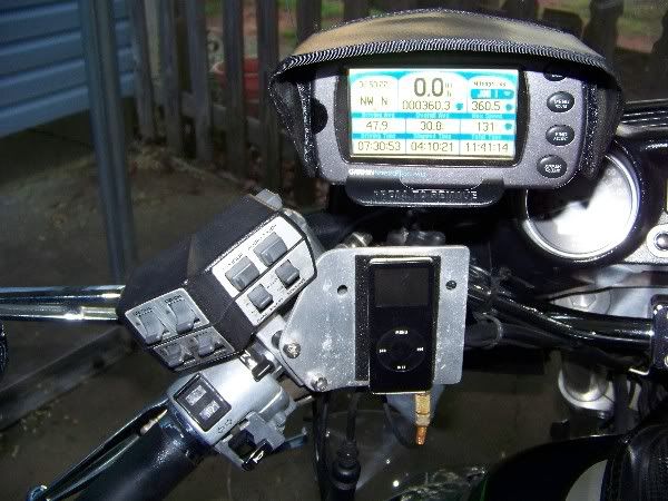

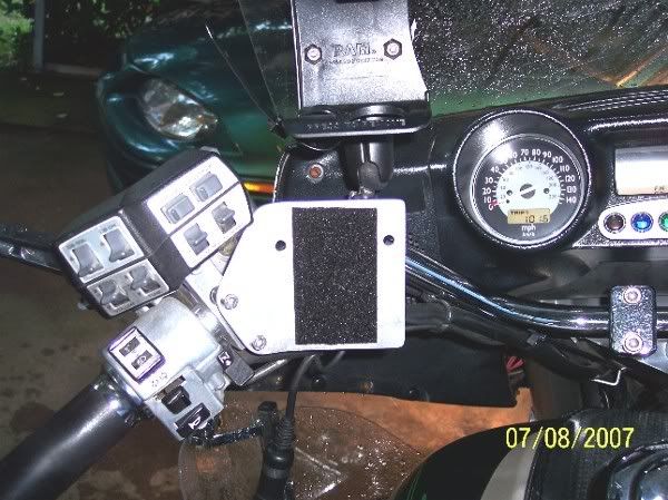

I've hand made all my mounts.
Left & Right reservoir clamps can be handy.
My material of choice = Ace hardware. 1.5"x.125" flat bar aluminum. Configure, cut, drill, form, sand & polish.
Left-side for headset coupler holder. Right-side for Garmin & it's XM antennae puck.
Rigid as heck. The Garmin doesn't move a bit or vibrate at all. Even on an HD it wouldn't vibrate any more than the bars would.
