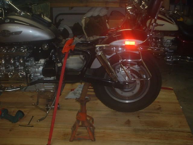

Here's my cheap bastard "work table", no lift, just a VERY stable platform.
Four 2x12's on top of 4x4's 8' long with 2x4 stringers underneath. Ramp visible in the pic.
Made the "tire squeezer" out of 2x4 tubing & 1/8" plate with a 3/4" jackscrew.
Bought six 6" eyelet bolts welded them closed & ran them through the 4x4 with big backing washers for sturdy tie down points.
A small floorjack, a 2" square tube with jackstands for lifting the rear half of a Valkyrie. Ratcheting tie strap to the eyebolts makes it rock solid.
To lift the front I use the same small floorjack & put the stands under the engine guards. The ratchet straps tie it off real stable.
I'm still able to get up & down very well so I wasn't concerned with the lifting aspect of the table but after balancing my '97 on a MC jack alone I said never again.  Shocked
Three bikes in a 2 car garage means that I have to park one of the Valks on the table when it is not in use. Mission accomplished.  cooldude
About $125 in the whole set up. I already had the jack & some of the scrap steel used in the build.
Very happy with it.  Cool
