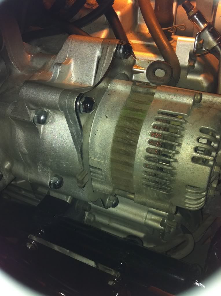

Here is the alternator ready to come out.

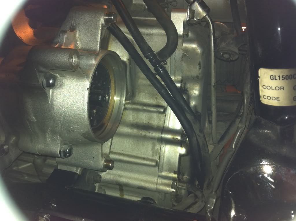

Here us the empty hole.

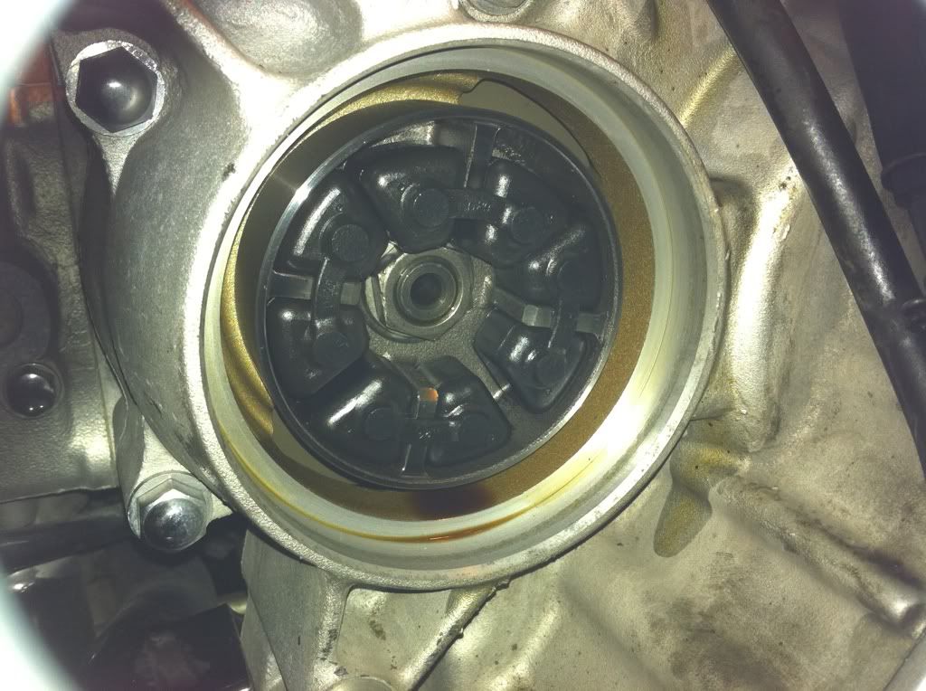

Here is a good shot of the dampeners.

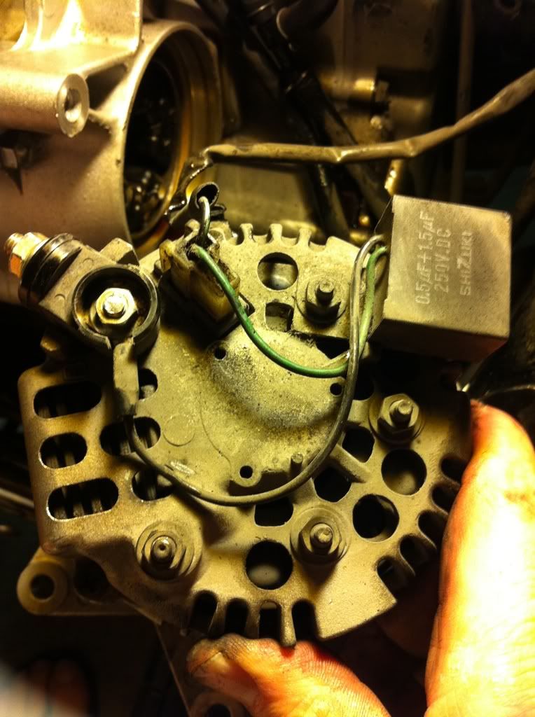

And here is the reminder as to where all of the wires go when putting it back together.

Once I got to where I could take the alternator bolts loose it only took me 5 minutes to figure out how to get the unit out of the bike.  We will see if gettin the new one in is as easy.

1/2 the price and essentially the same unit.  You just have to take the 4 long screws out and "clock" the front housing to match the Valkyrie alternator.
