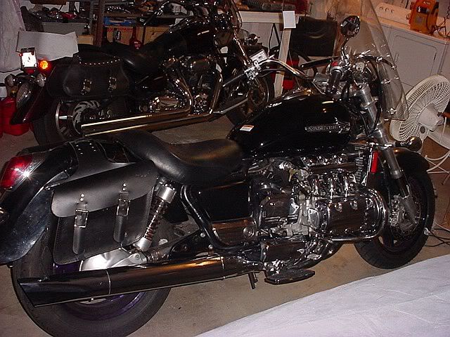

1st pic is the bike as I got it before going to the heap, non running.
Yes those are purple handle bars!!!!!!!
2nd as it is now, you know whats in the background.....
