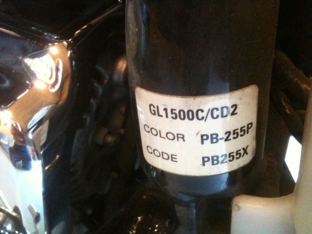

I got the paint codes off the inside of the bike.
PB-255P
PB255X
But I guess those are both codes for the BLUE.
We did a test panel on the pearl white from what the paint scanner thingy said, and it's not even close to a match.
Can anyone offer any advise?

I don't trust it though.  It's got mine wrong.  Everything I have found thus far says that my blue is "Pearl Coronado Blue".  Which this shows as paint code PB255M.  Mine is PB-255P and PB255X.
Which of the MANY whites and silvers is mine?
Shouldn't the paint code be on the bike somewhere?  Why does mine only show the main color?

just went out IN THE RAIN and pulled the left sidecover on my 98 bl/wht standard. tag says: P255P and P255Q

Just went out and checked my cream and blue 98 and my colour codes were
PB-255P and PB-255Q.
I don't know why the cream isn't on the label.
Did you try the honda cream y173m code?  I looked that up at the colorite website.
PB-255P and PB-255Q
The paint codes should be under the left side cover on the downtube of the frame.
Right... But both my codes are for Coronado Blue...
Shouldn't there be a code for white too?

« Reply #7 on: June 05, 2012, 05:19:55 AM »
the two blue paint codes probably represent one for steel and one for plastic ?

Pearl Ivory Cream, Y137P is the factory paint code. It has two colors in it. Check this website halfway down http://www.bike-paint.co.uk/honda%201998.htm.

If I go back to 2001 for the paint codes on Color rite, I get this...
http://www.colorrite.com/matrix-colors.cfm?CFID=1724316&CFTOKEN=29724224
NH452M Pearl Alpine White
What do you guys think?
Is that it?

Whoops, sorry. Pearl Alpine White, NH452P on this page http://www.bike-paint.co.uk/honda%202002.htm.

I apologize to everyone for being short... I am just aggravated about it, but I think I got her licked now.
We did the paint scanner, and it didn't match at all.  The paint people say it doesn't work on PEARL paint very good.
I really do appreciate everyone's help.  Your help got me to where I need to be.  I hope.

I was no help, Jabba, because when mine were painted we didn't find a satisfactory paint code for the Pearl White.  I provided the painter with  a fender section and he matched it perfectly (or at least as perfectly as my eyes can discern.).

   Pearl paint is a tough match, you don't want a test panel. You want to spray what they call a let down test panel.   Take your test panel prime it, then mask it like you would shingle a roof. Top part of panel shows say 2 inches of primer, then there is masking paper covering the next 2 inches of primer. Do about 3 more sheets of masking 2 inches apart going down the panel.   Spray out your color on the top primer section, wait for it to flash off, peel the next piece of masking paper off, exposing the next 2 inches of primer. spray your second coat over the whole exposed section, let it flash off. Remove the next piece of masking paper, repeat the full coat over what is showing. repeat this till you reach the bottom of your test panel.  Let it dry, or clear it ,how ever you are going to finish the paint job.  Now take the test panel and hold it next to the part of the bike you are trying to match. Starting at the bottom work your way up the panel looking for the best match. When you find the best color match. count up from the bottom of the let down panel how many 2 in stripes you are from the bottom of the test panel.  That will be how many coats of your pearl it will take to get the same effect on the new paint job to match.      Hope that makes sense to you.

« Reply #29 on: June 07, 2012, 04:02:15 AM »
255P
That seems to be the code for the racing stripe scheme.  The code I posted earlier is for the white stripe.
