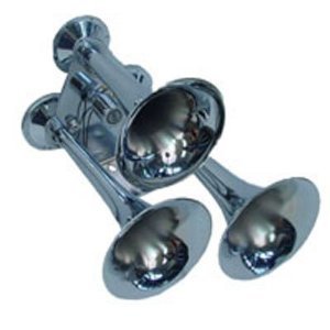

would these help? (hard to find a place to mount)
http://www.google.com/imgres?imgurl=http://ecx.images-amazon.com/images/I/31szE0CrFfL._SL500_AA300_.jpg&imgrefurl=http://www.amazon.com/Volt-Electric-Train-Grade-Chrome/dp/B002ITX2RE&usg=__x46_BKFGeOM94uyU8q3cHJFnd34=&h=300&w=300&sz=13&hl=en&start=2&zoom=1&tbnid=JPnAVrzcu_riiM:&tbnh=116&tbnw=116&ei=CFTjT8usF5Ge8gSm-rWGCA&prev=/search%3Fq%3Dthree%2Bchrome%2Bair%2Bhorn%2Bbig%2Brig%2Bhorns%26um%3D1%26hl%3Den%26safe%3Doff%26sa%3DN%26rlz%3D1G1TSHB_ENUS473%26tbm%3Disch&um=1&itbs=1

So how do we mount this on a valk?
Nathan Airchime K5HL Train Hornpowered by Aeva

So how do we mount this on a valk?Nathan Airchime K5HL Train Horn
Seen them mounted on the handle bars b4.
