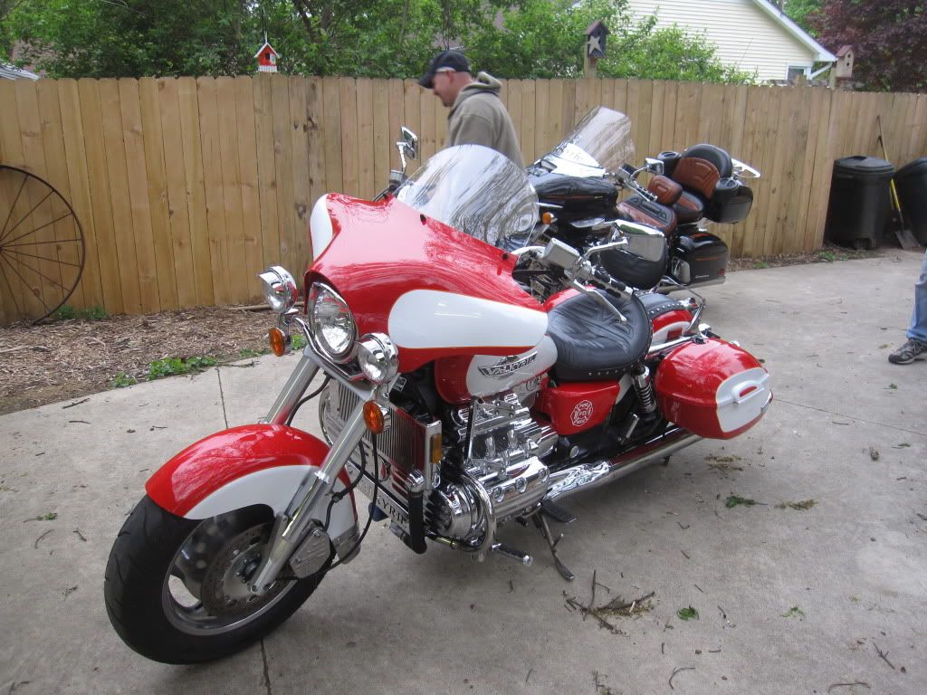

Put them on my son's bike, they are plastic and not that heavy duty we altered the leather valkyrie bag mounts and used re-enforced fender washers and a bottom support. so far they work good and look good.

Function and form being very important, I like the looks on that Valk Rtaz.  Very nice install.

Yes. I have those on my bike. That is my Red and White (thanks for posting pics RTaz, as I am still too dumb to do it myself LOL).  I really can't complain about these bags they work good.  Not the best quality but I have had no issues so far.  I would suggest using the factory leather bag mounts for them because of the support under the bags.  It seems to work well.  I have been in rain and the only water that got into mine was where the bag latches (water filled up in the latch part but nothing in my bag got wet).  If you are looking for a high quality bag I would probably pass but if you are in need for something economical that locks these are good.  Just make sure you don't use the mounts that come with them because I can see how they would crack.  Good Luck.
