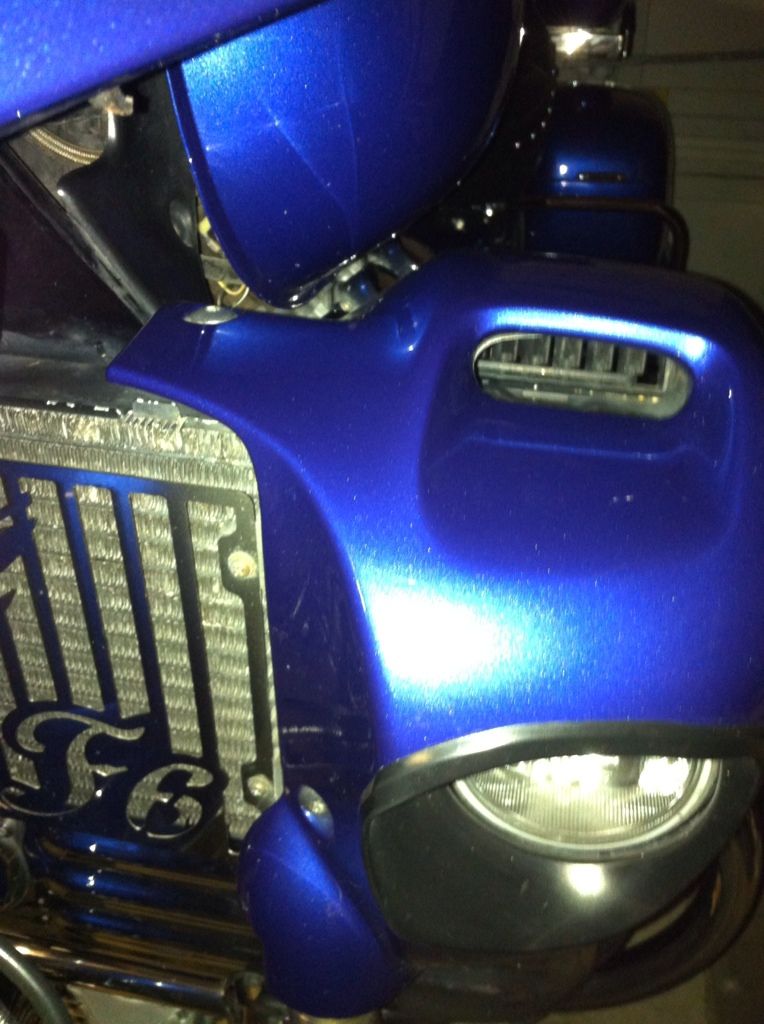

« Reply #2 on: October 21, 2012, 03:43:34 PM »

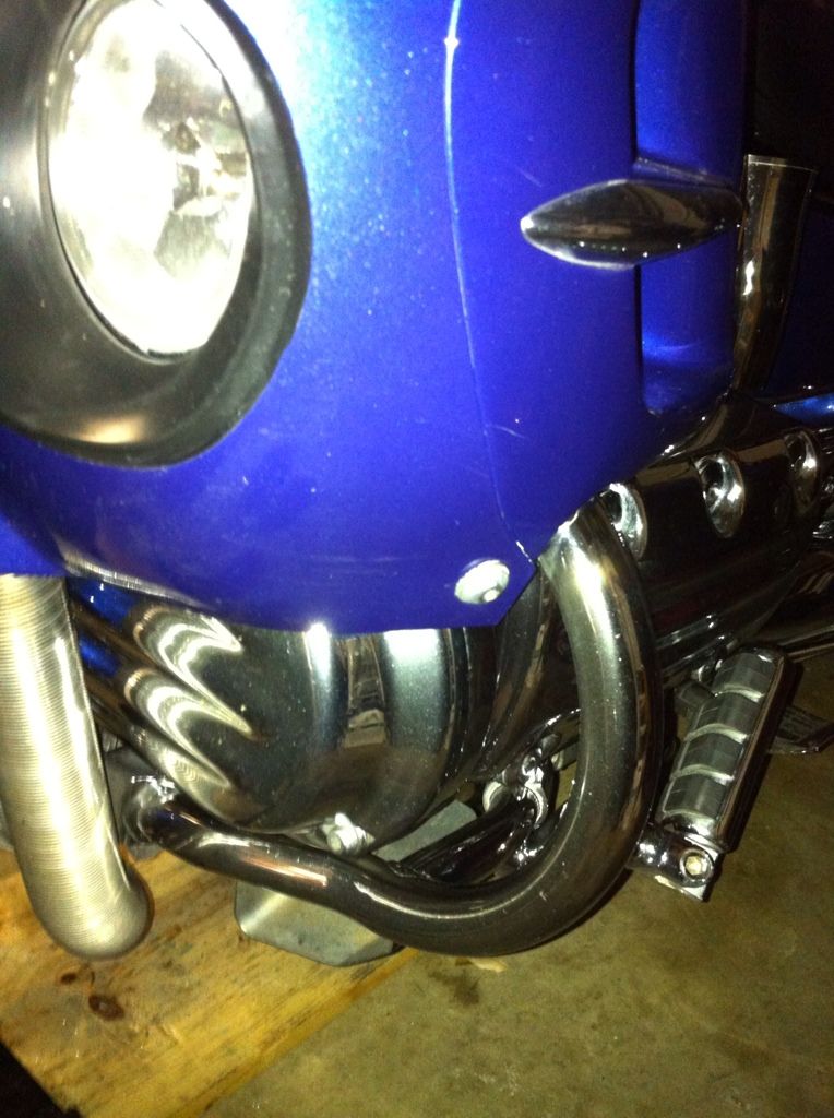

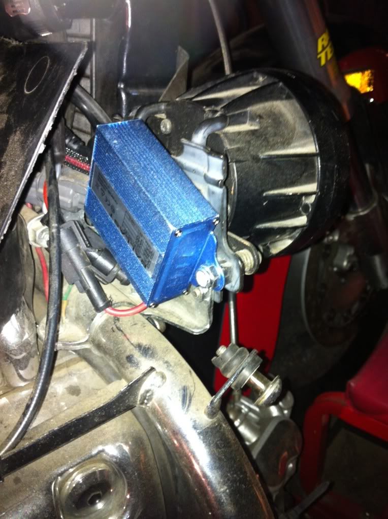

There are three bolts that need to be removed to get the pod off.  The two in the left portion of the first picture and the one in the middle in the second picture.   The first two are the same length, but the third is longer and make sure you don't put it in the horizontal front location as this has been known to puncture the radiator tank.
After removing these 3 bolts, pull outward on the rear of the pod as there is a barb in a rubber grommet holding it on.  From this point all I can say is to wiggle it while pulling it outward and be careful of the light switch plug.  After you get the pod off it is pretty easy to replace the bulb by taking the back of the housing off.

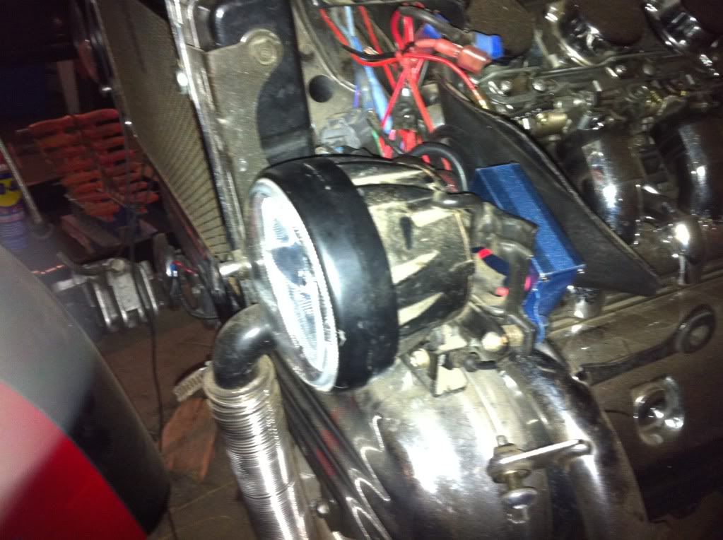

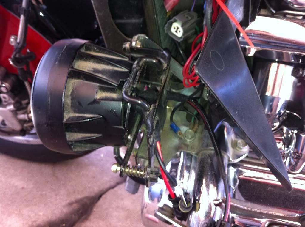

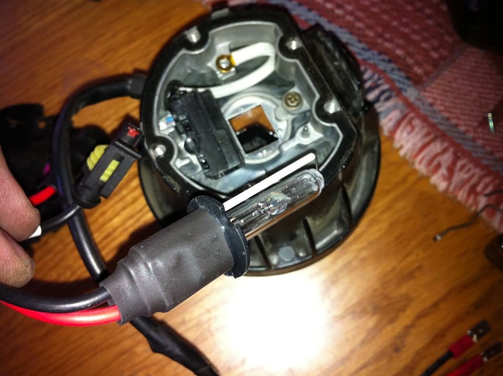

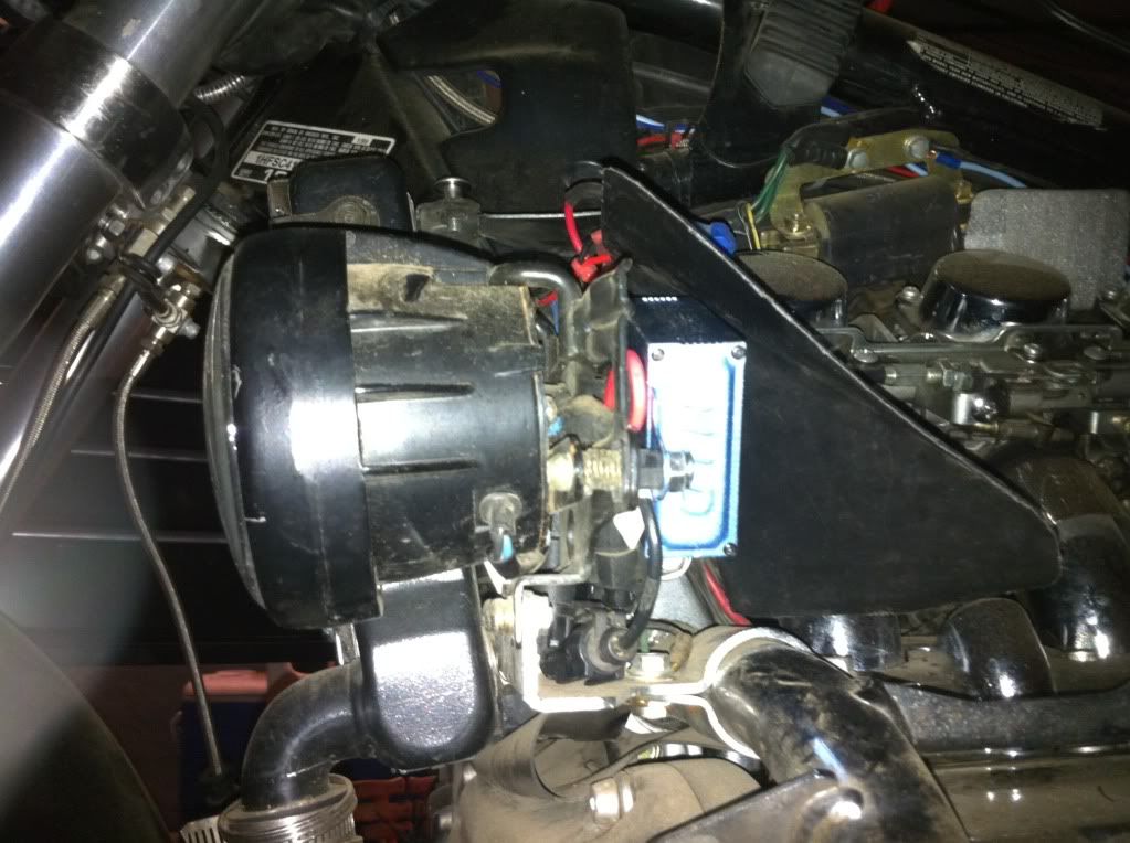

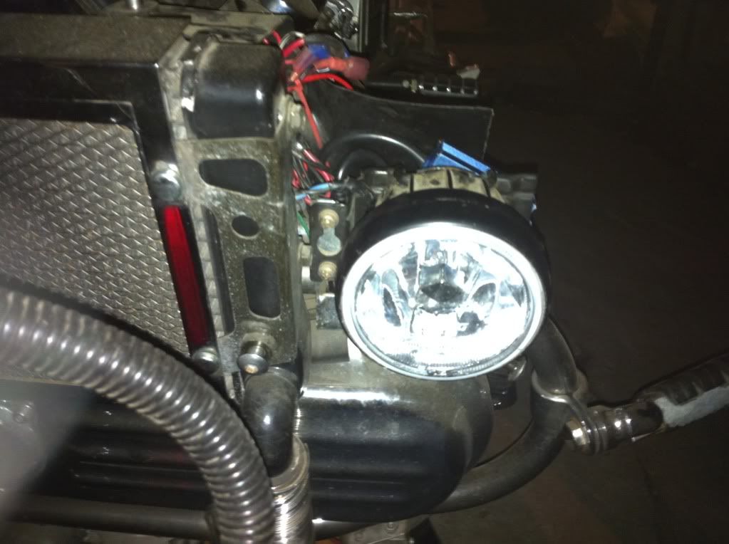

I upgraded to HID 35watt bulbs although I did have to do some modifications to the housings back plate to run the new wires through, mounted the Ballasts right behind the light fixture inside the Pods.

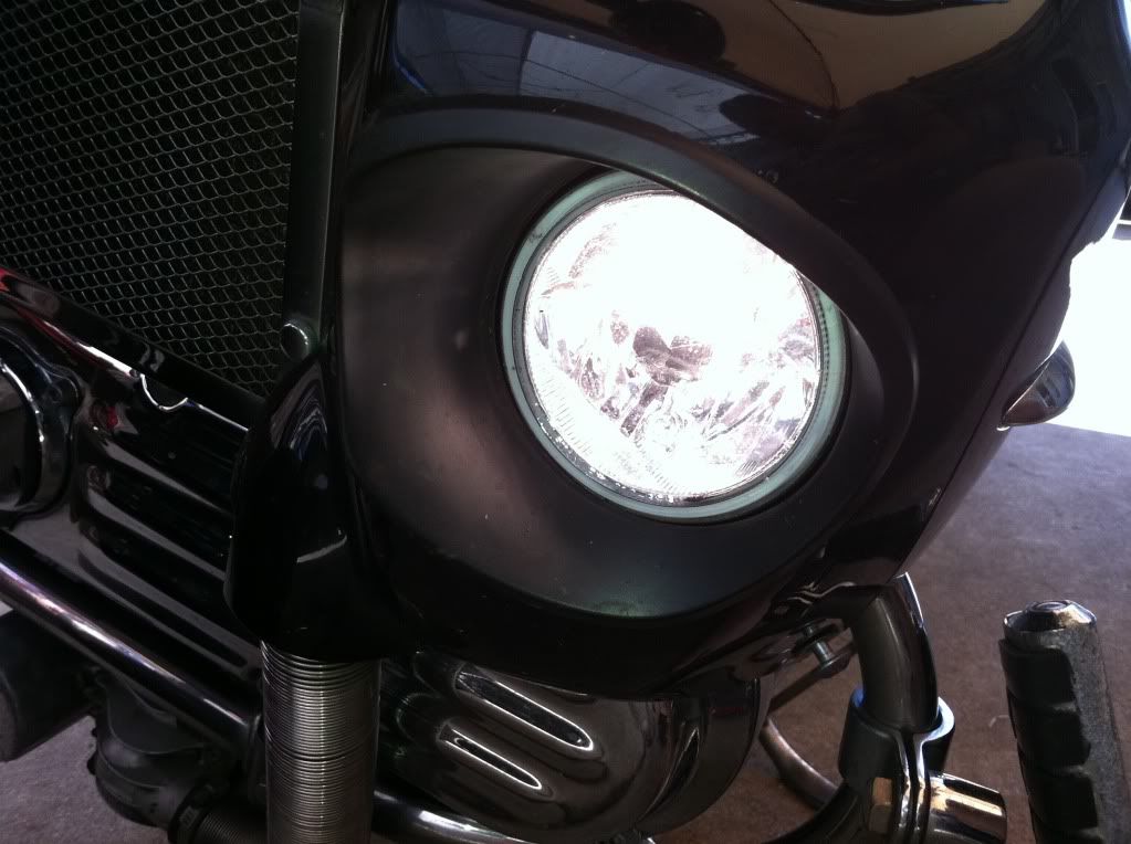

This is the comparison to the color of the light the blueish greenish lights are the HID and the Whiter light is the 55watt PIIA although the HID is a lower wattage used and is actually brighter down the road throws light farther and wider.

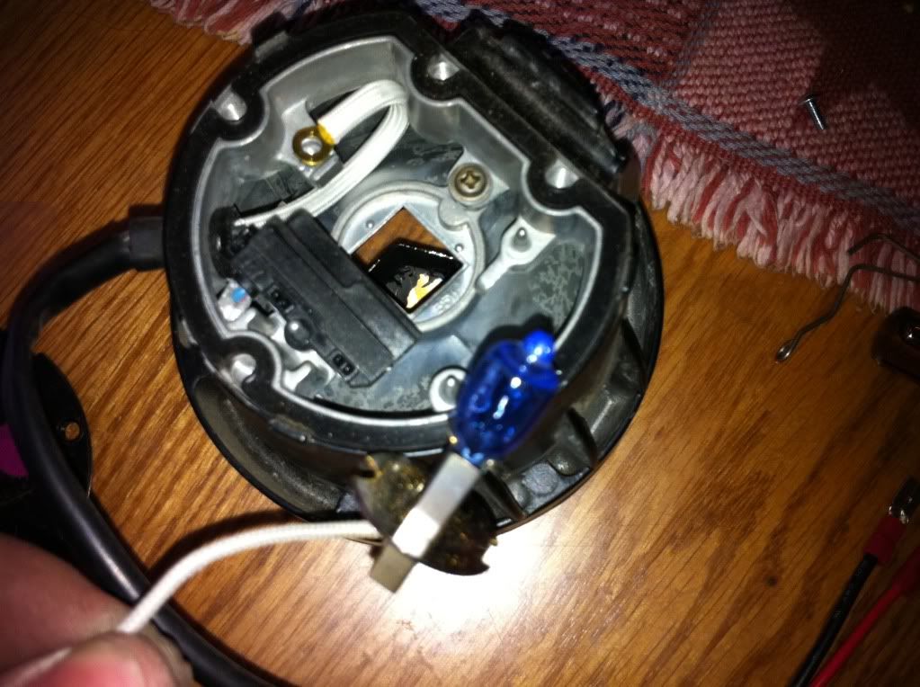

Original style bulb, this is the PIIA brand ultra white version 35watts.

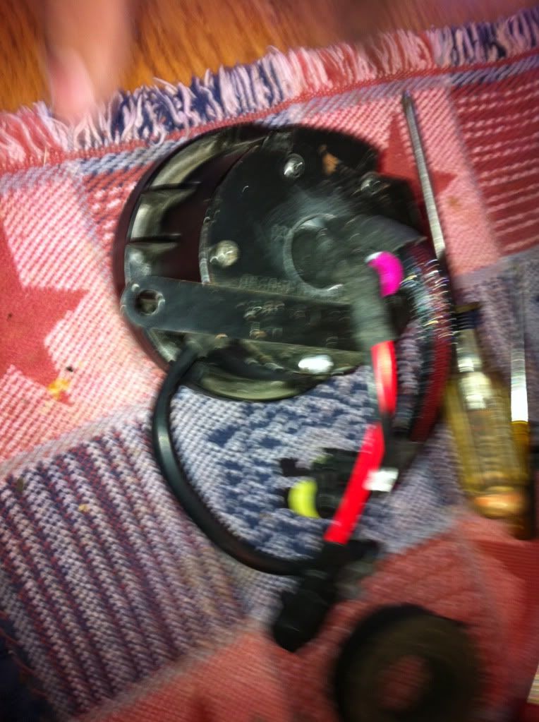

If you look carefully you can see that I had to file the rounded locator slot on the one side to fit this NON Honda bulb in, use a jewelers files that is half round works like a charm.
This is the Upgrade HID bulb, you can see how much longer the bulb is. It actually touches the inside of the lens of the fog light housing but seems to be fine after some 10,000 miles
If memory serves I gave less than $45.xx shipped from a Ebay vendor for the complete fog light HID kit includes both sides and the ballasts be sure to verify the ballast are the newer style MINI ballasts the older ones are a pain to mount due to size. IF you wanted to go this route..
