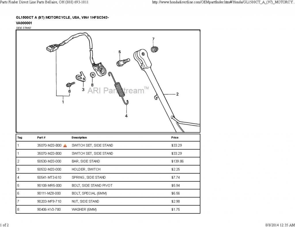

Here is an image of the HDL web page as of 08/08/14:
Chrisj CMA's reference to part # 11 is no longer applicable.  OOPS, I was at the wrong end of the spring.  EDIT 08/08/14
A new link is THIS, we'll see how long it lasts.

Posts: 14887
« Reply #14 on: August 08, 2014, 04:59:12 AM »
Its still #11 on the HDL frame page...
http://www.hondadirectline.com/OEMpartfinder.htm#/Honda/GL1500C_AC_(97)_MOTORCYCLE%2c_USA%2c_VIN%23_1HFSC341-VA000001/FRAME/GL1500C-97-AC/2Y14MZ0VMZ04F3300CB
Strangely its called a "hook spring"  In the listing below, but that has to be it
« Last Edit: August 08, 2014, 05:02:22 AM by Chrisj CMA » Logged
