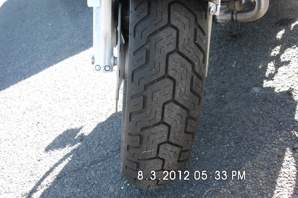

I have a Dunlop D404 130/90-17 bias rear, $123.95 delivered, on the front of my IS (only 3mm shorter than stock, the 150/70 is 15 mm shorter which would alter the speedo considerably); with a Falken Ziex ZE-512 205/65R-16 on the back, both at 40PSI with Dyna beads for balance. I've been from Edmonton, Alberta to Southern Ontario twice, over Lake Superior. It has over 20K miles on it now. This is what they looked like at 17K miles last July...
Fred.

PhredValk, is your Dunlop D404 mounted reversed?  I can't believe how much tread you have after 17K!  That looks pretty wide.  Any tracking issues?

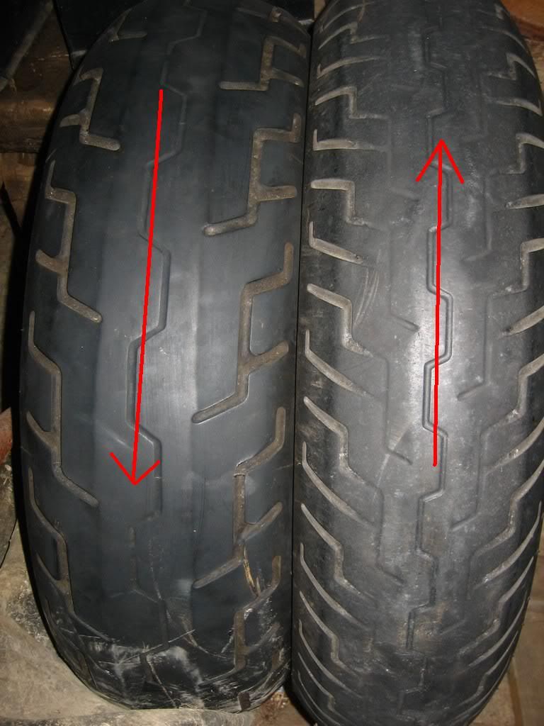

I remember someone on our board saying they talked to one of the tire manufacturers. They posted that the rear tire on the front should be reversed because of lamination reasons. I personally didnt talk to the tire company. This does make sense. I run my front tire backwards for that reason(KENDA CHALLENGER 130/90-17 on the front and General altimax 205/60-16 rear). I also live in New Mexico and we don get much rain. When it does rain, I slow down anyway.

According to mfgrs (can't remember which) the tread cap on a rear tire is lapped so that the forward  torque from acceleration won't hurt the tire; and rearward toque of braking is not nearly as hard as on the front tire. The front tire is lapped reverse to this, as there is no acceleration torque on the front tire, but the huge braking torque needs to be addressed. This is the theory, but I don't think I've ever read that any rear tire became damaged in this way.
According to Michellin, it should be safe to have a radial tire on the rear and bias tire on the front of a motorcycle; the reverse is not true and possibly dangerous.

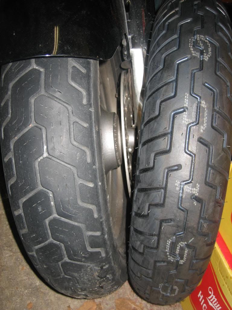

As far as Bias/radial setup, I have the D404 in the Bias ply up front, mounted in reverse.
and the Federal 535 Radial in the rear.
As I noted before, it's been in heavy rain, snow and sleet on the mountain pass and solid as a rock.
When I ran into that snow storm I was almost ready to turn around and head back home but was on I90 and had a mile or so to go before I could turn around, and had NO trouble getting there so I kept on going.
