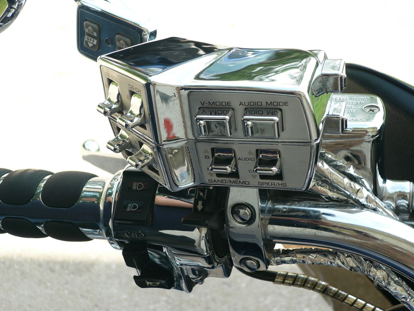

Does anyone have a link to the page that shows how to clean the switches in the Interstate switch pod. I seem to remember on that same page there was a tutorial on how to wire the switches for something other than their intended purpose.

I looked there before I posted the question and didn't see the pictures and directions that I'd seen several years back. My switches are getting dirty since I have to push harder than usual to get them to work.

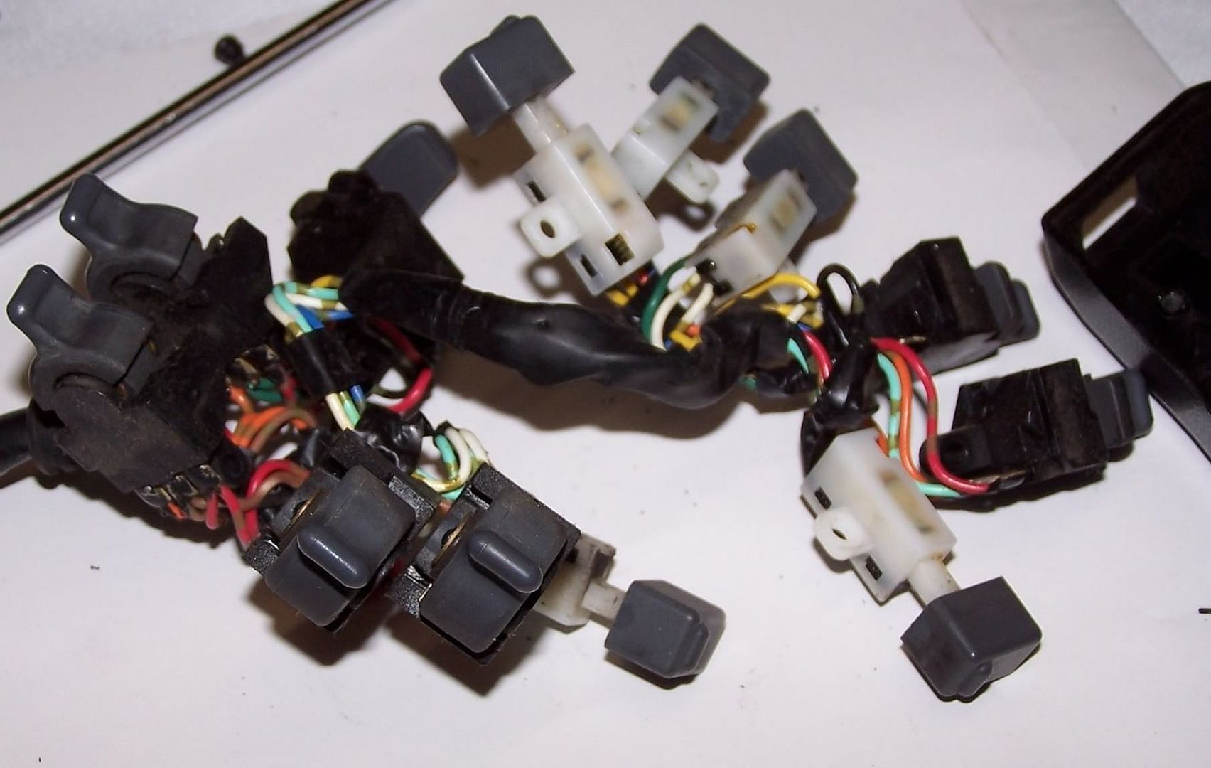

I have never seen instructions to clean them, but if you open up the box cleaning them would be pretty easy.  I stripped mine down and totally disassembled it and sent all the individual push buttons, levers, and case off for chroming and they are fairly simple little switches.
I took a huge amount of digital pictures "just in case" when I tore it apart.  If pictures of the "guts"  would help

I have never seen instructions to clean them, but if you open up the box cleaning them would be pretty easy.  I stripped mine down and totally disassembled it and sent all the individual push buttons, levers, and case off for chroming and they are fairly simple little switches....
Thanks Oyeaa... That's exactly what I needed to see... That little project turned out to be a great looking mod  Cheesy
