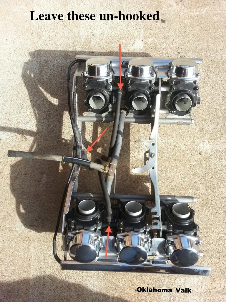

« Reply #4 on: February 28, 2013, 09:17:15 AM »
The purge lines do not hook to anything. (i assume by purge, you mean the two hoses coming off of the carb bank)
On your carb bank bracket, you will see two holes toward the back. The purge lines poke down through there. Do not hook them to the air box. Regarding the holes in your air box (has your valk been desmogged?) Bottom of your AB has 3 holes. One hooks to drain tube. One hooks to Crank case breather, One hooks to SMOG system. If your valk has been desmogged, someone may have left the hole un-plugged. You should plug the one you do not need.
Im not sure if this is the source of your problem, but it can't be a good thing AT ALL.
Make sure you used 1/4'' hose barbs on the dan marc, to allow fuel to pass freely. Make sure your new fuel line is OEM diameter. Make sure there is no sagging/twisting in your fuel line under the tank. Make sure your vent hose is clear and not being pinched.

« Reply #6 on: February 28, 2013, 10:20:11 AM »
I've become pretty good at getting the air box off.....its putting the darn air box back on that I hate! Haha.
Those two lines keep the vacuum pressure behind the diaphragms equal. Important shannanigans that I really don't know how to explain. All I know is they do not hook to anything.
Yes it should take 10minutes at idle to run the fuel out of the carbs. Those carbs hold a lot of fuel. At highway speed, it runs out rather quick.
The brass tee is a great idea. That shouldn't be a problem. Lines can get lost in all of that mess, you aren't the first one to have an empty space in his air box. Take a picture of the underside of you box this weekend. Upload it to photo bucket, and post it on this thread. That will help us figure out the missing hose.

« Reply #10 on: March 02, 2013, 03:13:51 PM »
OK.....finished except for a test ride. It's late and too cold.
I disconnected the carb purge lines, Plugged the xtra hole in the air box, installed the K&N and re-installed the stock petcock after rebuild.  Replaced vacuum line to the petcock and made sure there were no kinks or bellies in the fuel lines and the tank vent.
Let it run for about 1/2 hour to get to temp.  Revs and holds to red line w/o breaking up.  I held it at about 4k rpms for about a minute w/o a whimper.
So, those purge lines were prolly picking up the vacuum from the air box and starving the carbs somehow.

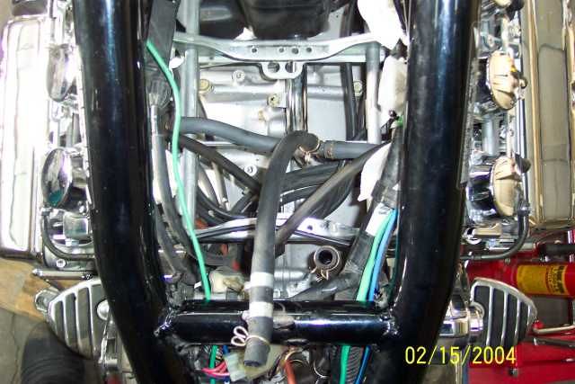

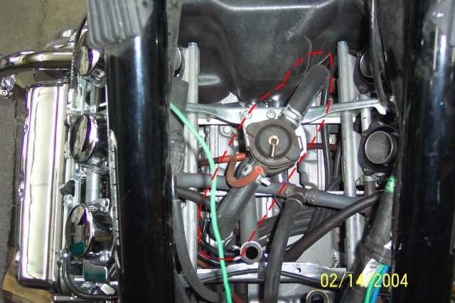

« Reply #16 on: March 03, 2013, 07:58:54 AM »
Here's what a desmogged bike would look like
Here's what a smogged bike looks like.
Those images were taken from this thread in shoptalk:
http://www.valkyrieriders.com/shoptalk/desmog.htm
Which one does your bike look like?
Let those who ride decide.

« Reply #17 on: March 03, 2013, 09:58:13 AM »
Thanks OK Valk........mine is desmogged.
