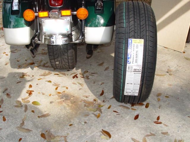

Just wanted to put one up and see if I can get  it to work on the new board.   cooldude  This is the tire that I just installed on the Intersate.  I put 450 miles on it last weekend.  Much easier to turn than the Bridgestone that I took off.

    What tire is that?

It is a Michelin Primacy MXV4 205-60/16.  So far I like it better than the Bridgestone because of the more rounded edges.  Not the cheapest tire you can buy, but the Bridgestone was on for over 4 years and was getting long in the tooth.  It wasn't worn out with 20 or so thousand miles, but at least now I don't have to change at 8 or 10 thousand miles like I did with the motorcycle tire.  My rear Avon's always cupped out even though I ran 40 lbs. in them on the rear.

Terry, That Bridgestone appears new. John was changing his out too due to age and also looks like new.             They certainly wear well.

Terry, curious....how much? I'll be pulling the rear end down for maintenance before long and thinking of replacing the c/t I have on now. It's a few years old and about the same mileage as you had, still plenty of tread. This looks like a good replacement.

Looks like you can get it from Tire Rack for $136 + $22.36 shipping.  I paid a little more because I just stopped into a tire store in Brooksville while there for something else.  I was surprised that it had more room beside the swingarm than the Bridgestone.  No compaints on the Bridgestone other than this one is more rounded and turns much more like a motorcycle tire.  I have yet to run it in the rain, but with the tread pattern that it has, it should do well and this is the V rated version.

The plan was to put on an Austin tire. I like everything I've read about it, but...it would look better if it were wider, and that new tire Terry is putting on looks good, and the profile is great as well. Can you give us more info Terry once you've mounted it and have run for a while? Such as clearance, nut cage mod yes or no, height compared to stock, etc. Thanks in advance.

Pete it has been on the bike for 450 miles.  I did the nut cage and washer mod when I put the other tire on.  It has more side clearance next to the swingarm than the Bridgestone did.  I dismounted the old one and mounted this one myself with my Harbor Freight tire changer/motorcycle adapter.  It has a stiff sidewall as did the Bridgestone which made it harder to change but I like that.  If it suddenly loses all the air it will hold it self up better than a thin sidewall tire like the Goodyear triple tread.  The only thing I can't vouch for is handling in the rain yet.  It feels much more like a motorcycle tire than the Bridgestone did, but I really didn't have that much problem with the Bridgestone.

I like the profile on that Michelin. Please keep us posted if anything out of the ordinary comes around with the new rear. I need to keep this one in mind when I change mine.

And it is made in the U.S.A.  But anyway it was just something to post a picture of on the new board.  I'm not pushing it, just personal experience.  When the 225-60/16 gets a little more age on it that is mounted on the Rocket III, I think I will put one on it.  I may drop back to the 205-60/16 like I put on the Valkyrie.

 Q on your new tire pattern = IT's 'not' even on both sides and I always looked for one that was. Understand that you have not ridden it in the rain yet, but other than that the uneven pattern works ok, right ? If you don't have a problem with it, I guess I won't either, so I'll give it a try. The General was really flat when it went down, so  guess the sidewall was too soft anyway. Again , thanks for the info Terry, you're still the best 'guru' in my book  --  c-ya  --  rick in NC

Hey Rick good to know you're still kickin and ridin.  I put another 250 or so miles on it down to Tavares last wekend.  No complaints yet, and yes I think it is what you call asymmetrical or the pattern is not the same starting in the middle and working out.  I sure hope it works well for everyone that does try it as I don't want to get any hate mail.  Cheesy
