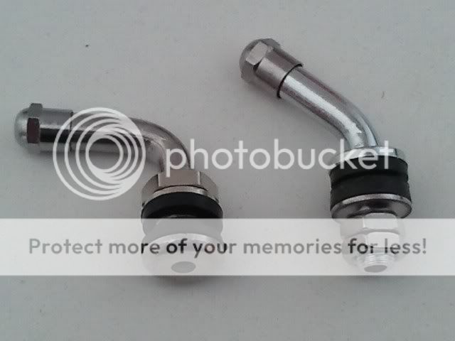

Heads up. I ordered some 90 degree and 45 degree stems.
The 45 degree stems still tighten from the inside.

Well I was going to change mine out, but they look brand new so I'll leave them and yes they're rubber. The rear support is broken, so I ordered 2 new ones at Honda .......... 5 bucks apiece, most likely worth more than the stems. New tires next year so I'll have them changed out then.
If you want valve stems similar to the picture below, I purchased them at Raynard Automotive Supply, 3209 9 St. SE Calgary, for certainly less than $5 each.  They might have the nut on the outside style too, but I didn't ask at the time.
Good info, thanks.

was it at least decided that we did NOT have to grind downt he TEE to get any of them on, especially teh "anchor"
No, it wasn't.
You'll need a style that has enough vertical portion to clear the tee or you'll need to remove the tee.
Some do.  Some don't.  The anchor style definitely does not.

The 90 degree ones from Jake Wilson clear the tee and you can still use the plastic support.

The flush mount Anchor stems require you to grind the T off if you want them aimed to the high side of the bike (hmmmmmmmm, the right).  It is no big deal on the front, but having them aimed to the low side of a tourer or IS under the bags on the rear is a PITA.  Of course I forgot to mention this at my first tire change, so they got ground off and turned around next time I needed a tire.
