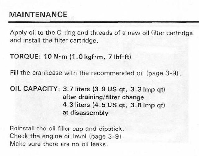

k thanks for all the reply now my next question with a new filter how much oil do i put it i believe it says 3.75 liter cause i'm canadian.....so that is about 3 and 3/4 quarts of oil or do i have to put more if i put a new filter on....cause the filter will take almost a quart itself

From the service manual: 3.7L. If you buy your oil by the US quart, 4 quarts = 3.78L. Close enough.
So I guess i would need  4.3 liter of oil if i change the filter and oil like you are suppose to do according to the chart you are showing me .......Dam i hate the metric system easier just to put in 4.5 quarts and not 4.3 liters....thanks for all the help people...
3.9 quarts

Read it again. 3.7 litres when you change the oil and filter. 4.3 litres if you disassemble the engine.
