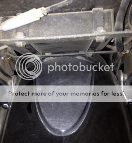

Well---I feel like an idjit ---here's a shot of the tail light cover--and it sure looks like the CB won't allow for the stock fender light.
I like the LED bar---what is the best route to go that way? Really want these tail gaiters to notice me when I gotta stop fast..... apologies to those whom took their time to inform me about the stock tail light option!

I have no CB, but have read that it can be turned sideways or around fairly easily to clear a std tail light lens.  Any help with more detail here?
I would have mentioned it earlier, but you didn't say there was a CB earlier.

Used CBs generally go for a pretty good price..... could pay for all the rear lights you want.
But really, if you want to keep it, I have read it can be changed around in it's mounting under the trunk, believe it was sideways and the std tail light lens will fit.  Others have posted about doing so in the past.
To me it just made sense to add a light where one was deigned to go (with OE parts available) with a knockout already in place.  Mine with an 1157 bulb only is definitely brighter than my smaller trunk lights.
