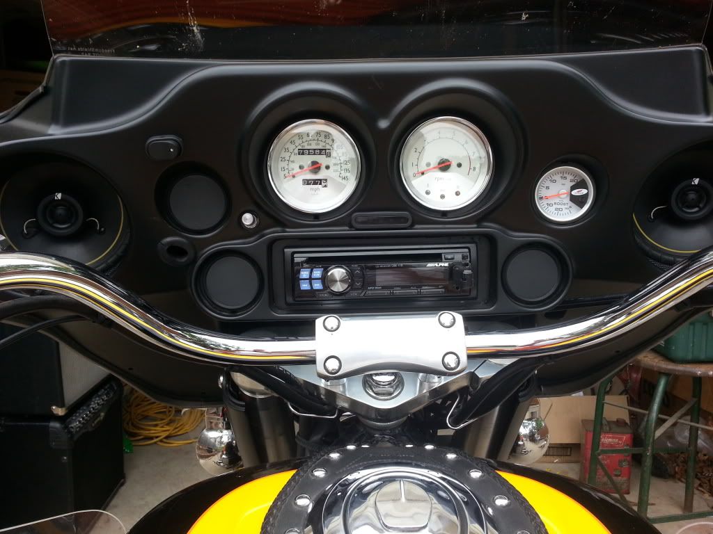

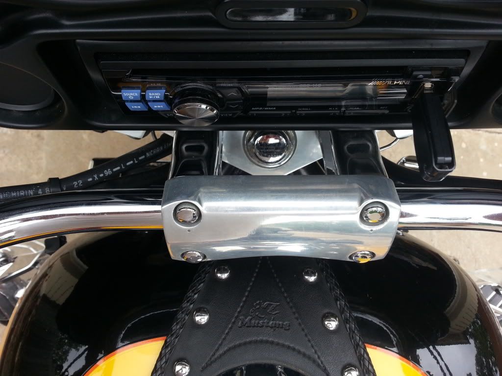

They sure feel lower in my lap than the OE's. Also, I have an early set of the LaMonster risers which do not compensate for the round indention in the forks. I used my OEM clamp top-piece due to pitting on the tops (only) of the Lamont risers. They provided a good amount of clearance for my fingers to punch the buttons on my stereo. Something that was hindered with the OE risers.

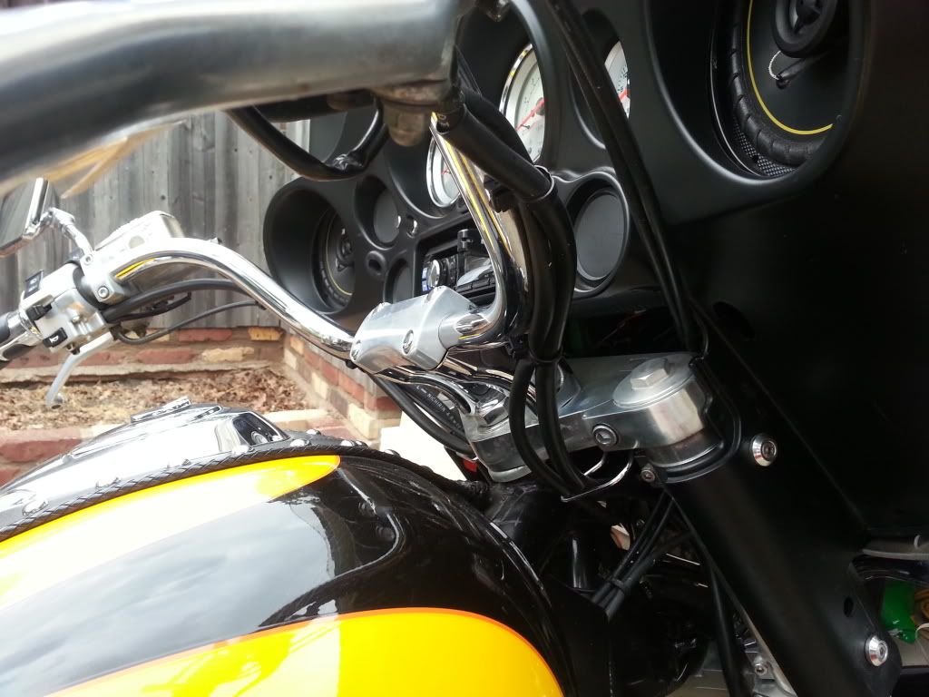

Remember this, all you have to do is loosen the topclamp and raise/pivot the bars in the clamp a few degrees, and the grips will come up considerably... of course, too much is stupid and will tension the cables.
BTW, that topclamp can approximate chrome with a little aluminum polish. (and glare in the eyes when in the sun.  LOL)
I got mine from Aeromach years ago; asked they price match the cheaper HDL LaMonsters, and they did.  I also stuck their Reaper topclamp on them.... no longer made. (there was some worry it might hit the IS tank, but it doesn't).

I used the Baron 4" Kickback Risers. Raises the bars maybe an inch and back somewhat. The ones listed for the VTX 1300R will fit, comes with three sets of bolts so use the ones that fit the best. The ones supplied are about 3/4" to long where they go thru the tree but just hacksaw that much off. You don't have to change any cables or wires unless you roll the bar back towards you to much. Rolling them back shortens the slack and forward gives you more slack.
