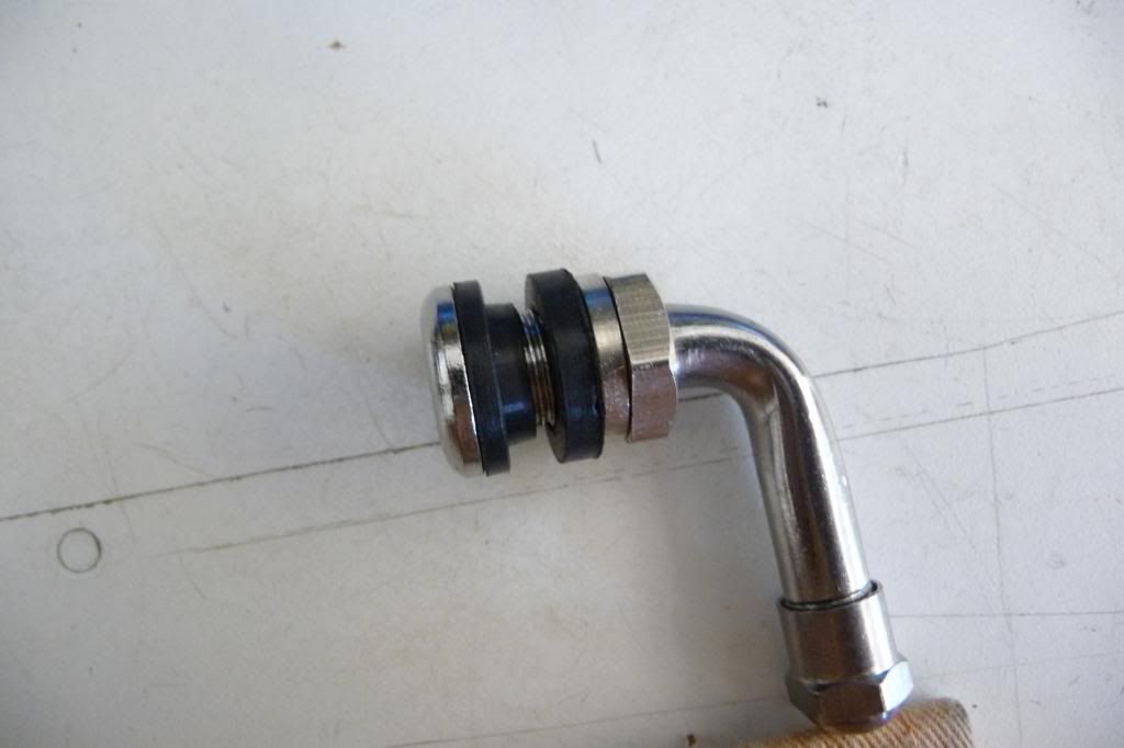

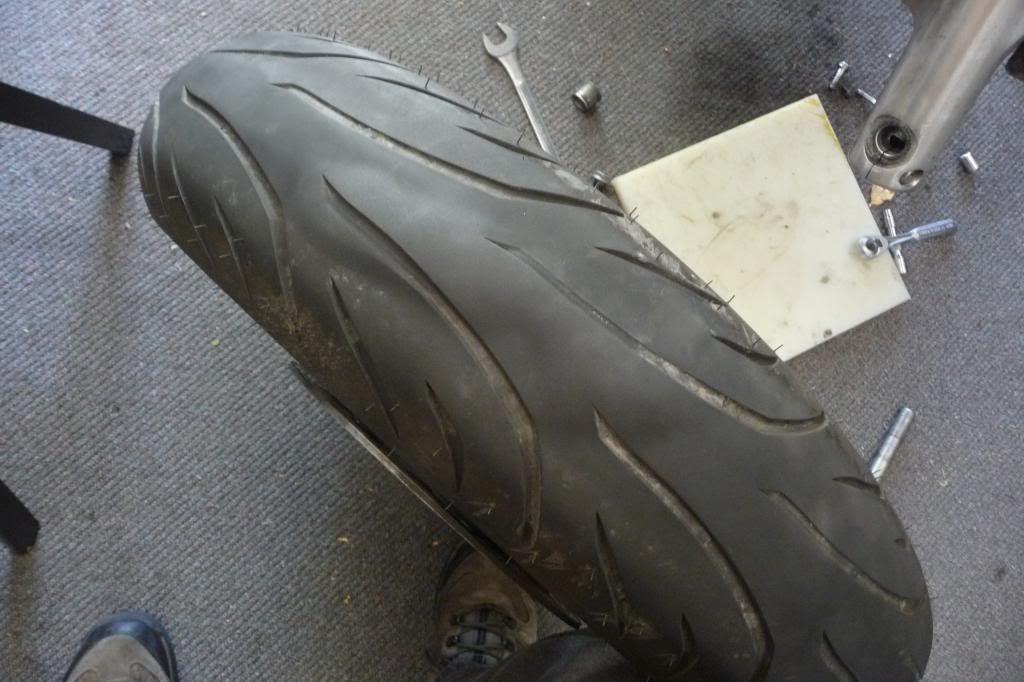

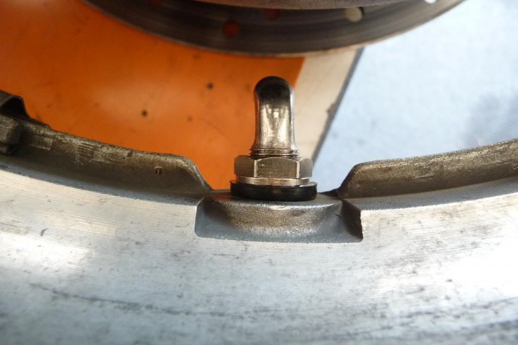

I think my Shinko has the mumps.... 2funny crazy2
I am not real happy with these valve stems.....there is no way to positively lock the tension on the gaskets and would have preferred a slightly cupped  washer to cover the outer gasket. Seems easy to over tighten and squash the gaskets.....elected to use a little locktite.  At least the nut is on the outside rather than the other version with the double nut on the inside...... crazy2
Wow! Did it happen all at once or gradually? Had a Shinko awhile back and had vibration I couldn't get rid of ,but that looks bad tickedoff

It became noticeable over a distance of 4-5 miles on the freeway then limped it home another 30 miles.....

Serious ply separation with the tire.
Heresy regarding the valve stems.
