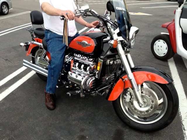

Ok, I've searched and posted this on the general board, but I thought I would solicit opinions from those of you who ride in Texas.  Any new development in tires?
Oh, here's a pic just to get you to answer.   coolsmiley

Always run Metzler steel belts.   ,, car tire works great on the rear for a valk. cooldude
And yea, Disco, way to step up .. Great ideas... cooldude
Nice toys there z10... cooldude
Oh and cool..very rare color combo Valk . no?..

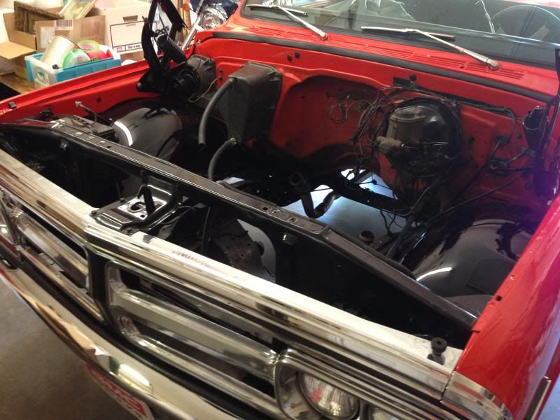

Well, we're getting to ready to find out!  Thought you guys might like to see a few photos of what came out and what's going back in.

« Reply #23 on: June 18, 2013, 07:46:51 PM »
Nice!

« Reply #24 on: June 29, 2013, 10:30:57 AM »
Now that's a great way to hi jack a thread, lol..
Have you've gone with a 383, aluminum heads, balanced, etc.  Should be sweet!!

« Reply #25 on: June 30, 2013, 02:25:54 PM »
Well I did start the thread.  cooldude
It's a ZZ4 Chevy crate motor.  350/355hp/405ftlbs.  I have one in my 69 Camaro and love it.  Hopefully I'll get every thing painted in the next week or so and we'll drop it in the GMC.
