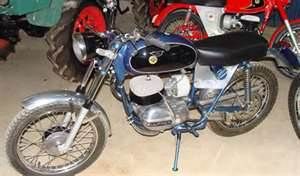

+1 on buying a new petcock. Daniel I used to have a little one "Lobito" like the one below:
