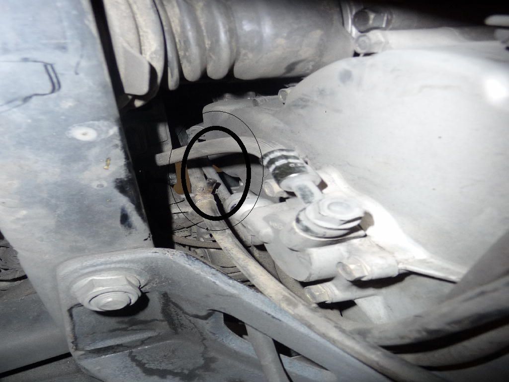

No John,, different T, the one you are looking at is the crankcase breather,, the one referred to here is the fuel tank vent. Check the petcock as Rio suggested, if it is leaking vacuum, you have found your problem and replacement parts are reasonable on eBay..

John, here is a pic of the tee location...Down under the right foot peg and up by the clutch slave cylinder.....inside the circle.  Simply cover the open port and apply vac/pressure to the open end of the hose and see if it is clear through to the tank.
I would still encourage you to apply a gentle vac to the vac nipple on the petcock and see if it holds and doesn't drop off. Also inside the petcock, the diaphragm has a hole in its center that slides over a little nipple.....if that has come off it wont work properly.

OK....Just so I'm entirely clear here....the "tank drain hose" is the one at the center-rear of the tank, correct? And that hose should have a Tee in it, right?
If so, that's the problem: No tee.
When I removed the tank last year, that hose more or less disintegrated when I pulled it off. I never put it back on, as I had someone else clean my carbs. So it looks like he replaced that tube, but didn't put a Tee back in there.
So...I need a Tee, and then I'll probably shorten the tube a smidge as well.
