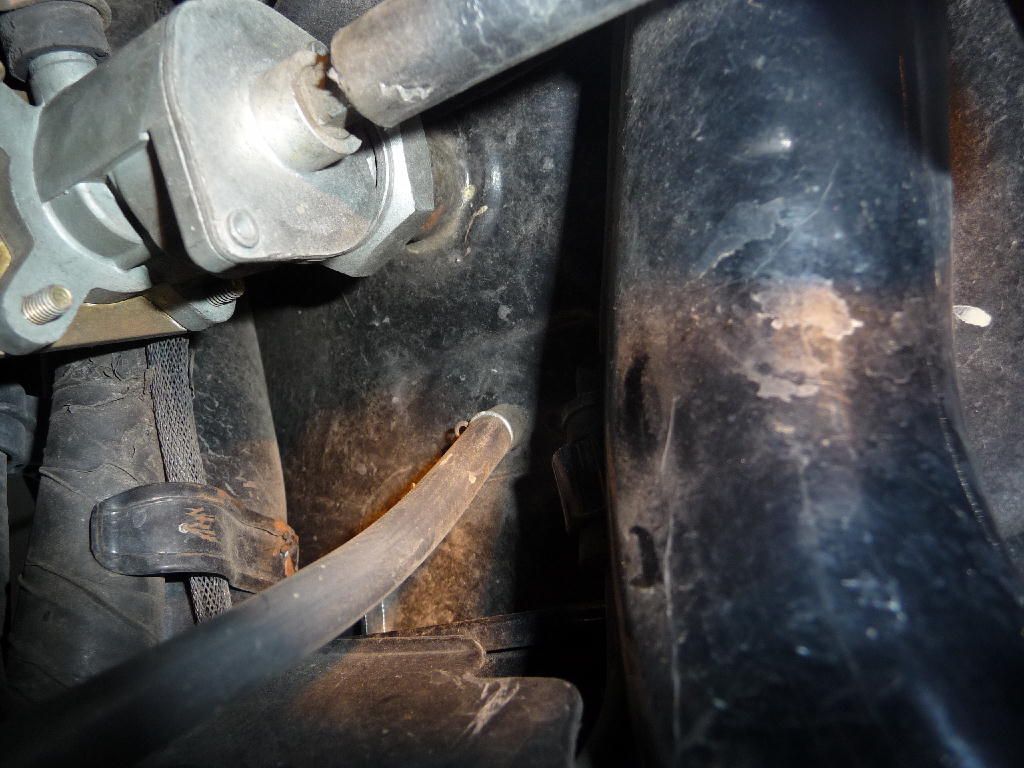

Yep, the port is to the rear of the petcock and drops straight down behind the engine by the slave clutch....ya know, we might be gaining some ground on your experience.  Do you have any idea of how long after the rain started that the event occurred?

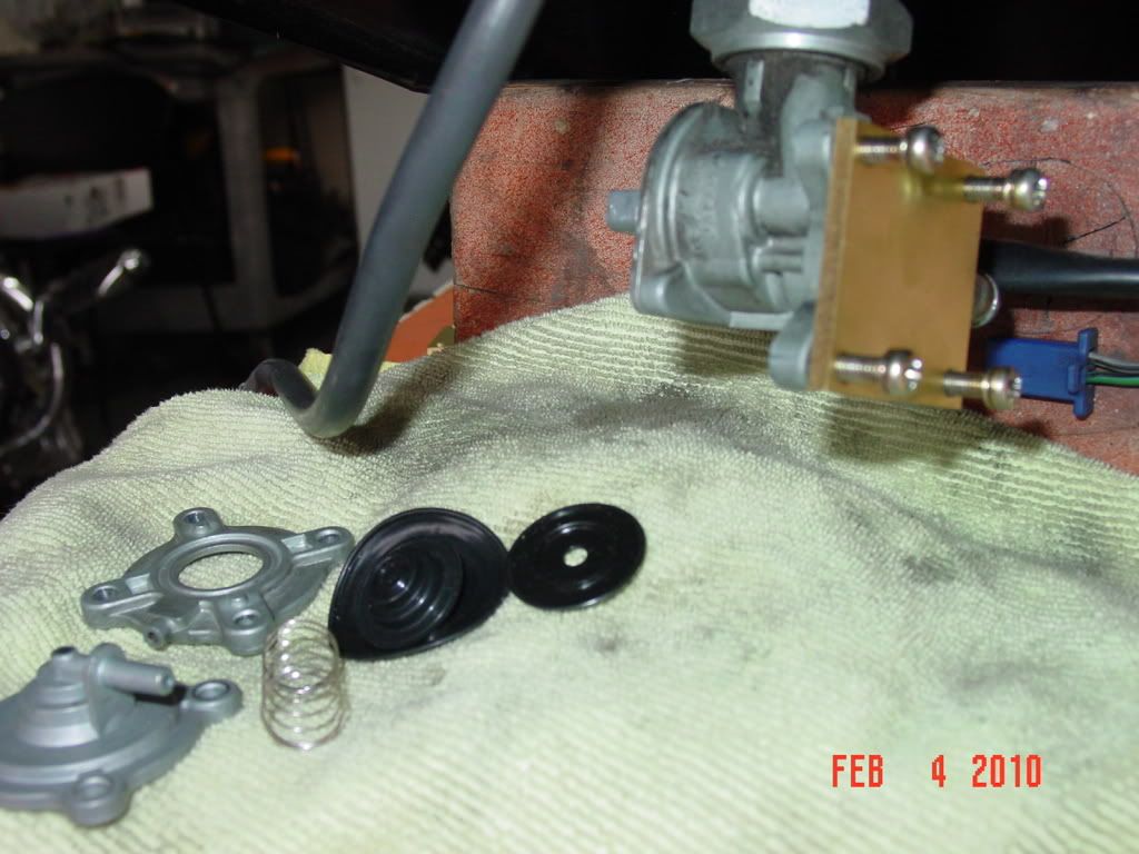

Just because you rebuild your petcock 9 months ago, doesn't eliminate it as a possible problem. Lower on the list, but still could be.
At least one person has report a second failure in a very short time (hours, days, weeks???) after rebuilding, and needing to do it again.
I was in the habit of every monday driving to work, after the bike was warm and on the highway, to turn the petcock off (I leave it on always), to see if the carbs would start to die out, which they did, then turn back one.

Just got back inside from putting a Tee in, btw.

Hey John,,, did you run a piece of hose from the bottom of the tee??
pancho
Posts: 2118
Bonanza Arkansas
« Reply #48 on: June 29, 2013, 03:09:02 PM »
I would still check the petcock with a oral vacuum check,,,,,,, just to rule it out or in.....
jabster
Posts: 87
« Reply #49 on: June 29, 2013, 04:11:37 PM »
Yes.

John.....as far as I can tell, we have beat this one senseless. Since it seemed to be a typical run the carbs dry condition and you found the missing tee, maybe that does it for you.  I think I would still check the petcock both for a vac leak off and perhaps take it apart again to verify that the diaphragm has not slipped off the little plastic nipple.  The reason I suggest this inspection, I did a rebuild and left on a 1500 mile 7 day trip.  It ran fine til a week after I got home, then started the fuel starvation act again.  Disassembling the petcock revealed the diaphragm has indeed slipped over the nipple and was not allowing the fuel to flow fully.....
Oh, a few years later at the next failure, I just gutted the thing and that's that!

I agree,, an old diaphragm with a hole is not the only mode of failure on these things.
