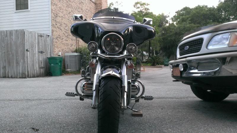

Dang!!!....how do you keep it so flipp'in shiney! No little chip/pock marks anywhere, the foot pegs have no hint of grunge.....I'm envious tickedoff tickedoff tickedoff
I have a I/S and tried upgrading my head lights form the obvious reasons and went to 100/80 bulbs on the first attempt.  Boy, was that an experience, the reflective road/freeway signs looked like flashbulbs going off as you passed them. Next dropped down to 60/55 watts and that worked real well....still a bit of flash on the signs, but a definite improvement over the stock 45/45 bulbs.  The lights now are as good or better than my F150 at night.
