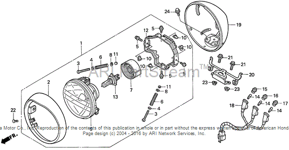

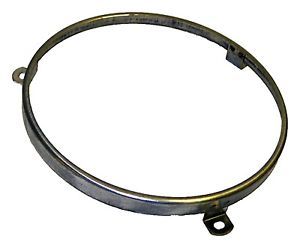

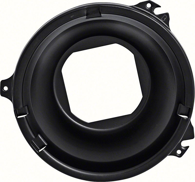

i got it installed today i didnt do a full on pic filled write up as i had planned mainly because it didnt turn out as well as i planned and i may redo it in the future. that being said i am also a perfectionist and wasnt really happy with the aesthetics of the way the trim ring had to be mounted in order for the ring/bucket to clear the mounting tabs on the valk headlight rim. i ill try to explain how i did it with stock pics though, it really only took a couple hours to complete but i am still playing with adjustments.
this is basically what i started with, along with something like this
 i disassembled the stock headlight and used number 12 in this diagram
and figured out where it needed to be attached to the rear of the above headlight bucket
i had it welded to the bucket but you could also figure out a way to screw it as well.
when i was done i was able to use one on the 2 spring/screw adjusters that are on the factory set up

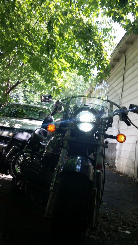

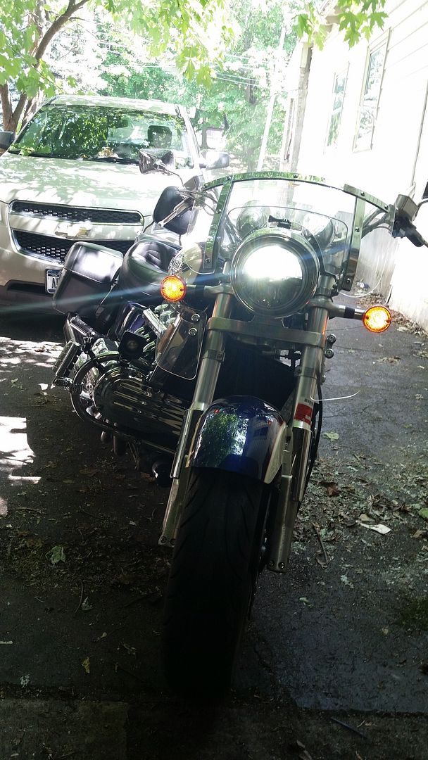

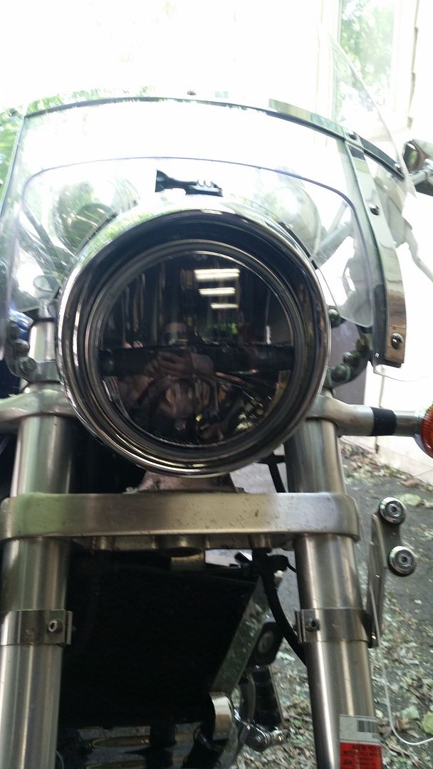

and so far that may be good enough but it is still a work in progress. here's a couple pics of how it looks on my bike
low beam
high beam
i will probably make a new mount at some point and perfect it and i will document that build when it happens but for now it is mounted solidly and i'll just keep playing with the adjustments.
