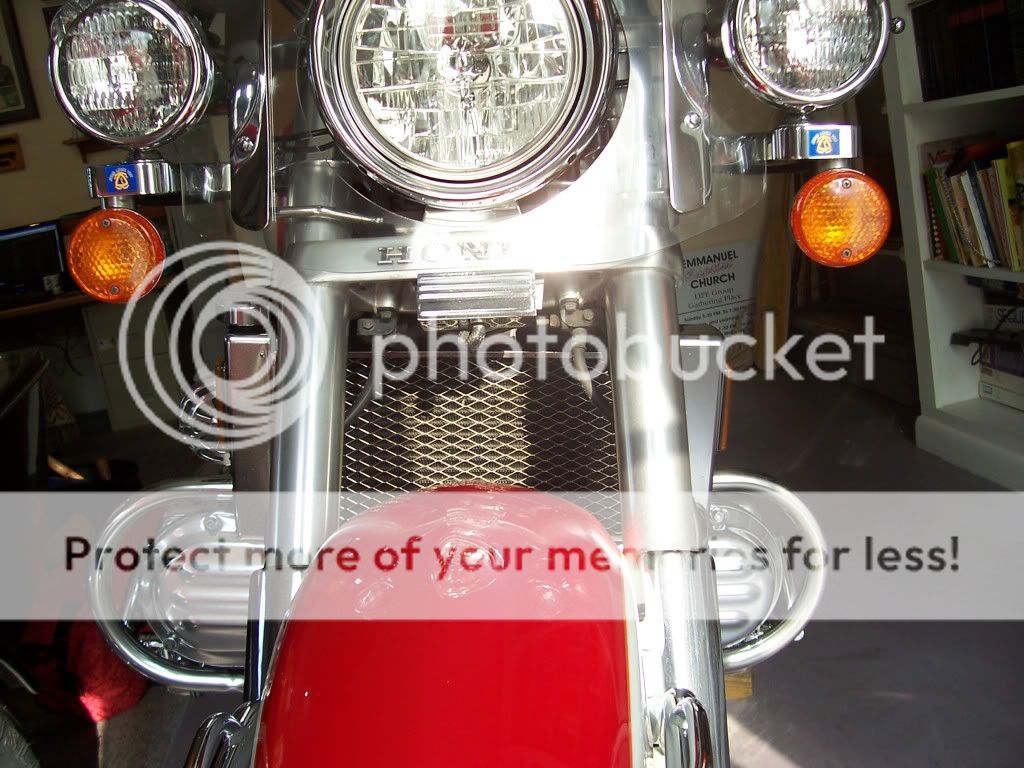

Chris, is that the amp mounted under the triple tree?
I'm actually getting one done this week Maxer.  I got a Shark system from the classifieds here.  Looks like amp under the seat, speakers on the bars with some chrome P-clamps and a black iPod cable from the amp, out the front of the seat into the tank bra pocket.  I will put up some photos when done.
Yes, that is the amp mounted under the tree.  The speakers are attached to the windshield mounts, hides them ugly brackets some and a side benefit....the sound is transmitted through the plastic of the windshield so the shield becomes an acoustic shell.  Besides, I have always detested add on attachments to the handlebars so this keeps it clean.
