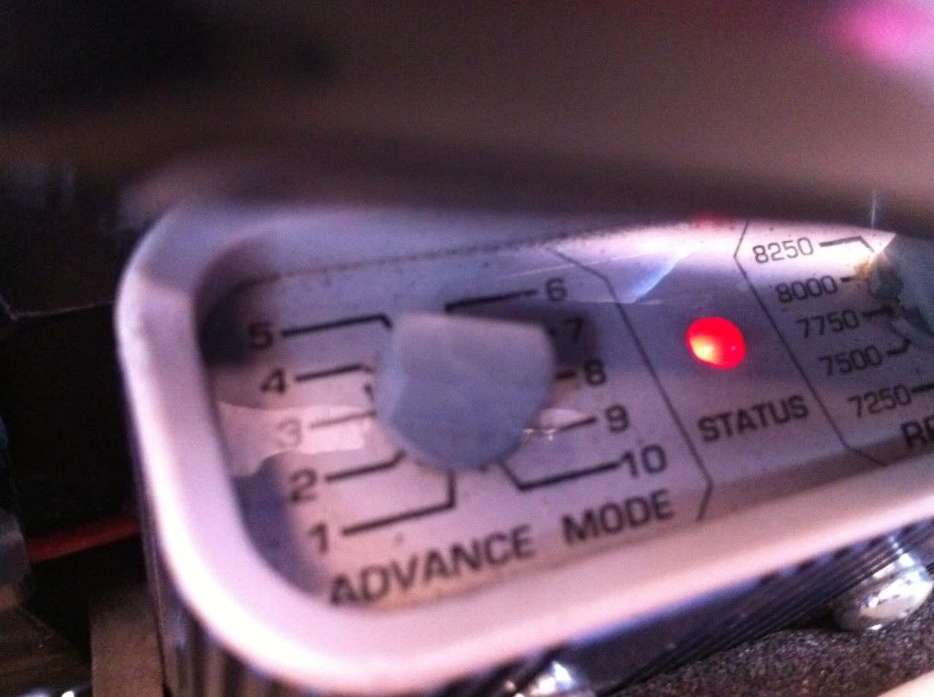

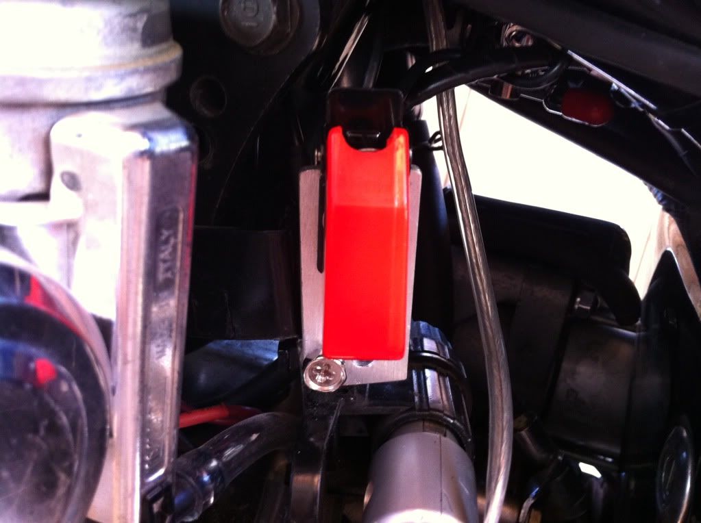

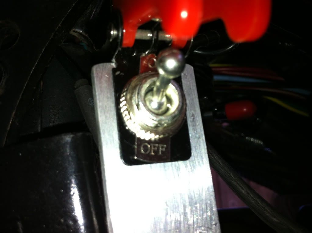

« Reply #4 on: July 14, 2013, 01:26:39 AM »
I am running the Dyna3K with a 4degree wheel on my I/S and if memory serves (often doesn't) I am using setting #7 but I also implemented the 10degrees of retard with a switch and ran my rev limiter to 7,750.
Stock pipes, K&N no prefilter, #38 slow jets, #105 mains.
So I have a mileage setting and a power setting. No dyno runs to prove anything but my Butt-dyno says it works well for me.
Looks like I have it set at either #6 or #7
« Last Edit: July 14, 2013, 01:31:37 AM by fordmano » Logged

« Reply #5 on: July 14, 2013, 03:58:27 AM »
 Shimmed stock needles, stock jets, Interstate springs, K&N Filter, no pre filter, Cherrybomb glass-packs in truck stacks. I tried two Dyna Ignitions, both at setting 7, both brought instant gratification and a smile (when they worked)
 First one was sent back and they replaced it free of charge. Second one developed the same problems quickly and worked intermittently on not too hot days. The second unit was sent back for a full refund.
  Now I run the same setup with a 6 degree TW and have had it in for maybe 6 years trouble free. Runs like a raped ape with no flat spots.
