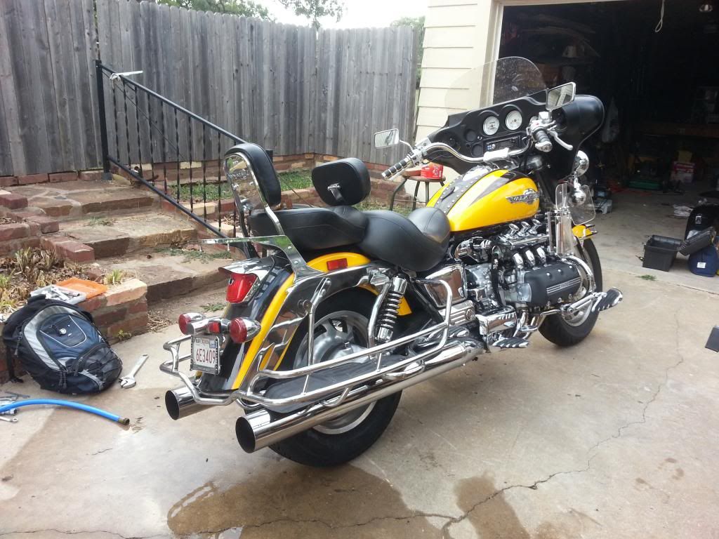

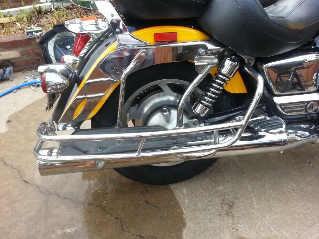

What a roller coaster it has been. When I bought my Valk a year ago, it had a 205/55/16 Uniroyal Tiger Paw mounted on the rear, and a Dunlop Elite 3 (OEM size) mounted on the front.
I've had a BAD wobble in corners and at high speed ever since I bought the bike. I replaced worn out shock bushings. Installed NEW 12.5'' Progressive 440s....stopped a front fork leak (using the 35mm film trick) and torqued the steering head bearings. Increased tire pressure in the Uniroyal to 44psi...
I still had a dangerous wobble....
When changing lanes, high speed, cornering...nothing seemed to solve it.
I blamed the Uniroyal CT. And I blamed it because it was a CT. SO....I recently bought (brand new) Shinko SE890 for the front and rear. OEM sizes. I purchased them from Motorcycle Superstore website.
I had a local MC shop mount and balance the Shinkos for me. I installed the shinkos and took the bike on her maiden MC tire voyage.It was then that I noticed I had a terrible vibration from 35mph-45mph. I put the bike back up on the jack, spun the rear wheel and noticed the rear shinko was terribly "out of round."
I was crushed. I spent days on the phone with Motorcycle Superstore and they finally agreed (upon seeing the video below) that they would send me a NEW SE890 Shinko rear.

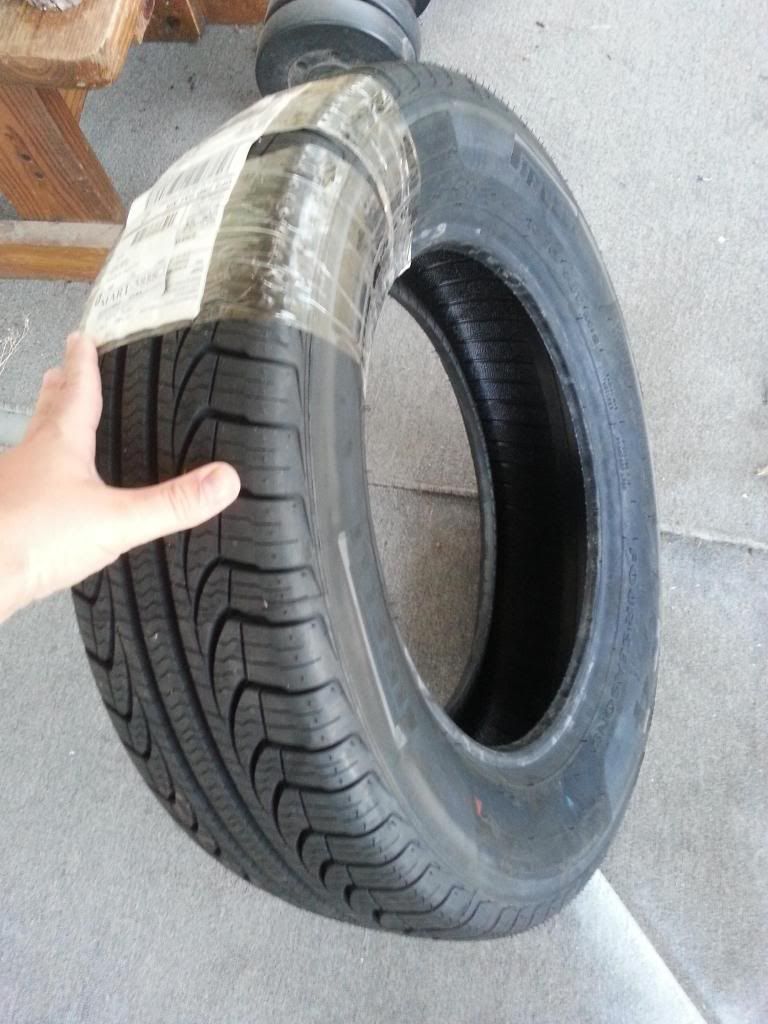

I liked how the shinko MC tires handled....but the vibration was killer. Too much. So I did some Car Tire polling and research. I found a review of the Pirelli P4 by RioWil. He claimed he got 60k miles out of the tire, and loved the way it handled. Good enough for me.....I felt drawn back to the dark side.

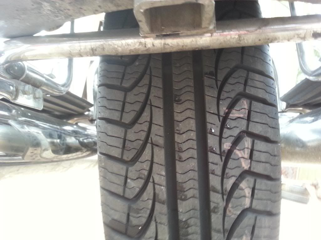

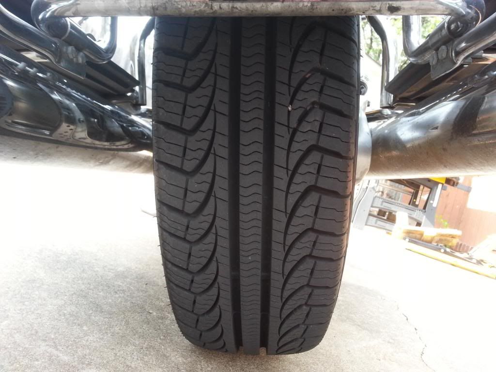

The Pirelli P4 All Seasons 205/65/16 is incredible. I dismounted the shinko, and mounted the Pirelli myself using tire irons. This was a LABOR of love. It was not easy, but I did it. Breaking the bead on the shinko wasnt too tough, because the tire was still soo new.
It took 40lbs PSI to seat the pirelli P4. I cleaned up the rear wheel, lubed and serviced the final drive, and installed the Pirelli.
It corners like a BEAST. AWESOME. It grips HARD and there is absolutely NO MORE dangerous wobble!!! The 65 height is sooooo much better for ME than the 55. At 65mph Im running 3000 RPM (or a little less)
It feels like a different bike. In a GOOD way. For now, Im going to leave the SE890 Shinko on the front. It has no defects at this point. I sure do love this new Pirelli. I do not see myself ever installing that Shinko MC superstore will be sending me. Im DS for life.
