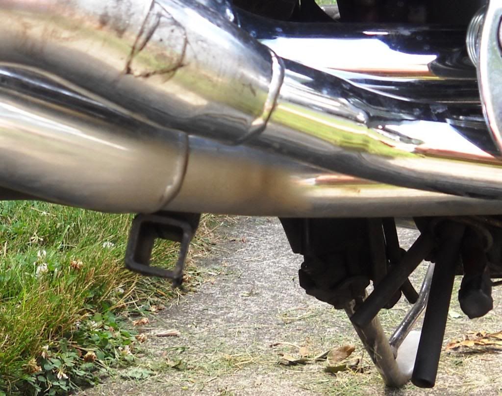

Can someone look at these kickstand pix and tell me if I need anything besides the spring? Also, the fiche shows two springs, a big and a small. A brief description of what goes where and why would be greatly appreciated. My encounter with whatever was in the middle of the road also bent my handy lift adapter. I'm thinking it may have prevented worse damage though.

Looks like the spring is all you need. I too once went to the stealer looking for the second spring. No such animal exists. You only need the larger, main spring. Your spring pin and kickstand switch look good to go!  cooldude
Glad that's the only damage you suffered when you "jumped" the carcass.

"should" be just the spring...but buy a pin too...as that thing is hardened and if it took a good whack it'll break soon...wiggle it hard and make sure it's okay.

Thanks Dan. Your advice was invaluable at 1:00am in the middle of scattered thunder storms. Gotta love bungie cords.

« Reply #11 on: July 24, 2013, 03:37:36 PM »
Here's pix of the bracket after removal:

« Reply #12 on: July 24, 2013, 03:43:19 PM »
How's the crossmember?

« Reply #13 on: July 24, 2013, 05:27:49 PM »
Crossmember looks fine. Straightened and re-installed the adapter and the new spring and all seems well. Spring pin was fine. I think I dodged a bullet on this one...
  Along with my new spring, My desmog kit came today also. Once my exhaust gaskets arrive, I'll be ready for the next project: cut down on decel popping!
